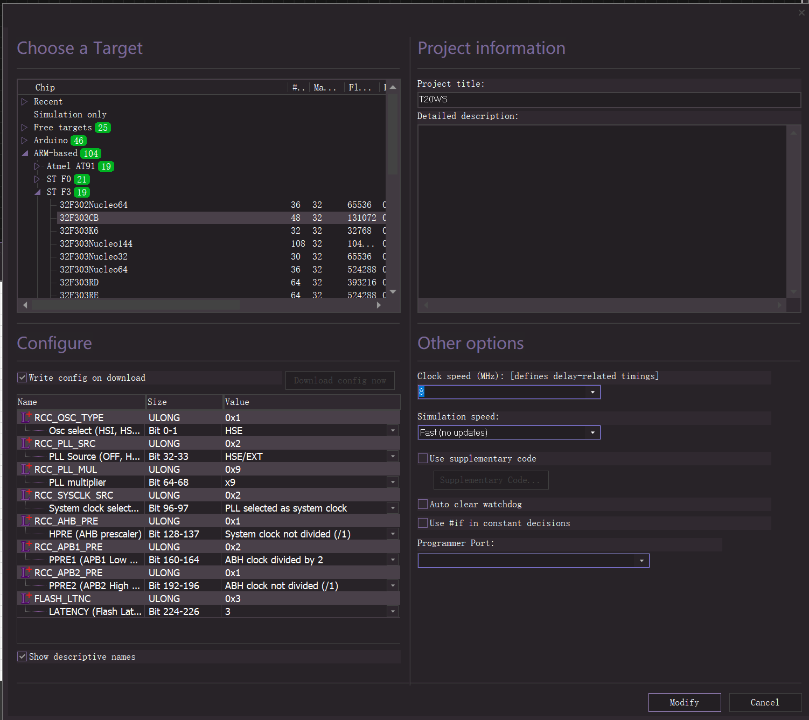

Step 1: I have set the Configure to have 72MHz clock speed.

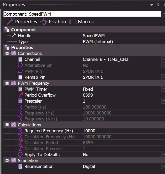

Step 3: In the Properties -- Calculations -- Required Frequency(HZ), I type in 10000, and get Calculated Period with 6399.
Step 4: Put 6399 in PWM Frequency -- Period Overflow

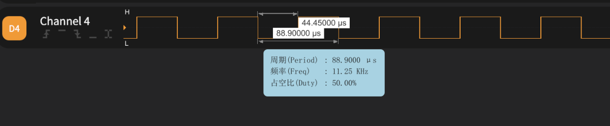

I have measured the output pin, and get a 11.25KHz signal, not 10 KHz. The DutyCycle 50% is correct.

MCU Configure Setting

Period 6399
Period 6399
