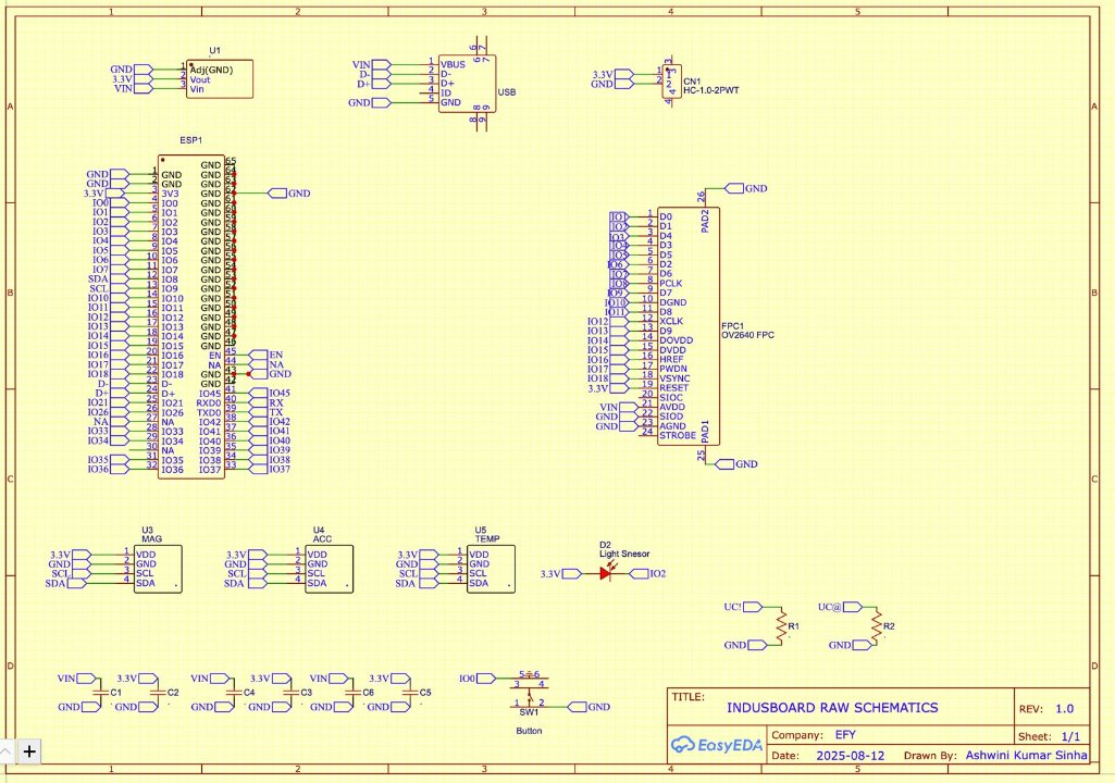

Have you fixed this error? I'm also facing the same issue. In my case, my ESP32-S2_mini board doesn't have a reset switch. Please advise. I have attached the schematic and compile error log for your reference.

I think the log file shows that the file uploads correctly - but can't reset the device..
Leaving...
WARNING: ESP32-S2FNR2 (revision v1.0) chip was placed into download mode using GPIO0.
esptool.py can not exit the download mode over USB. To run the app, reset the chip manually.
To suppress this note, set --after option to 'no_reset'.
See notes above about trying the no-reset option.
Leaving...

I used a capacitor, it work for me, reset after 2-3 sec. after power up the device if this is ok. I am not home at the moment, I come back when I come back.

After some playing the easiest way to not attempt reset is to go into the menuconfig (by running menuconfig.bat) and go to Serial Flashing->After Flashing and change to 'stay in bootloader'

... and Jorgen's tip is excellent - you need to add the capacitor to pull the chip into bootloader mode too.

Yes, I tried your method using menuconfig.bat, and the log file didn't show any errors now. I have attached it for your reference. However, after loading the firmware, the USB is not detecting, and the ESP32 fails to boot. The Flowcode file is also attached for your reference.
When I use this ESP32-S2 Mini board in Arduino IDE, I enable 'USB CDC on Boot" . It is working fine with Arduino.
I'm using this "https://indus.electronicsforu.com/" Indus coin rev2 board.
I will also try to add a Capacitor and see
For your information: I encountered this issue only with the ESP32-S2 Mini chip. I tested it with the ESP Wroom 32, and it worked fine.
