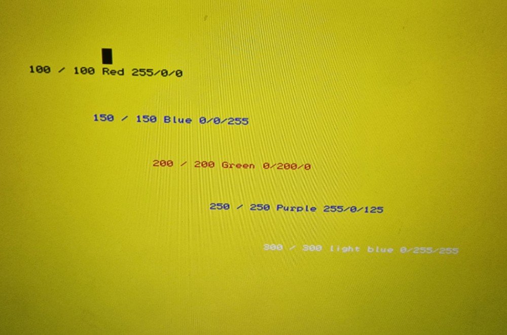

I have been doing some tests to get used to the HDMI component and it does not seem to be working as it should.
First off I could not change the background colour, I have given that a miss for now but do not like the yellow it seems to default to.
I then started looking at positions, font and colours. The positions seem to be fine but the colours are not, see image.
Red does not appear to do anything.
Green shows up as red?
Blue works fine.
Combinations also do not appear to work, in the test I tried purple (red/blue) and it still looked blue. Light blue shows as white.
The first numbers are x/y position, then the colour it should be and the RGB values.
I also tried different fonts which did not seem to work but that could be me so I will look it up a bit more first.

No access to hardware to check (travelling just now) but could it be an issue with R/G/B positions? It appears above that Blue is correct so maybe Red and Green are mixed up giving you G/R/B instead...???
Maybe try 200/0/0 for Green and 0/255/0 for Red (using values from above) to check?

The component was developed back in the days of 32 bit OS. I suspect that now with 64 bit the colour depth has increased. I'll have a play when I next get chance :D

I tried reversing red/green and probably worse as one text did not show at all.
I am going to try with a 32 bit OS now, will let you know how it went later.

Tried with 32 bit OS but still the same.

I was nearly correct 😁
I've just run it in debug mode (set 1 in the debug macro) and my setup reports 16 bits per pixel.
That's a lower colour depth than the code assumes.
The plot continues...

Just had a quick look at the component, and it looks like it uses the same colour encoding for the Raspberry Pi target code as for the simulation code, namely 32 bit colour depth and 8 bits for the individual colours. I think the Pi frame buffer (16 bpp) should be RGB565 format.
edit: Ah, silly me, these are editable property fields in the component :o
Change them to 16, 5, 6, 5 and all will be well :D

Thanks for all your help, it works a treat. The green looked black at 200 but at 255 it is fine. I have noticed you can change the background default there as well.
