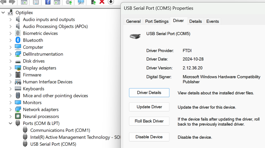

I use an original/genuine Arduino Nano, code A000005, purchased from Mouser.
It's an Arduino Nano V3 ATmega328 Development Board, which uses the FTDI chip (at least this is what I see in Device Manager), to which I have the latest driver:
Screenshot 2025-08-28 211529.png (234.28 KiB) Viewed 4852 times
If you want to troubleshoot together, I can make an MS Teams or TeamViewer session with you. The same, if a Matrix TSL employee wants to dig deeper into this issue - I am available to look together at my setup.

I also have an Arduino Uno R3 PDIP, and with this one, I have not encountered any problems. While both the Arduino Nano and Arduino Uno were plugged into the USB ports, the Arduino Uno R3 PDIP worked as expected, whereas the Nano didn't allow me to program it.
One difference is that the:
- Arduino Uno was set to a baud rate of 9600bps in Device Manager, and comes with the drivers from Arduino from 2015
- Arduino Nano was set to 115200bps, and this comes with the drivers from FTDI from 2024-10-28
Some forums were suggesting to burn the bootloader of the Arduino Nano with a programmer (I have Atmel ICE), or I could use the Arduino Uno with some patch wires. Strange that with the Arduino IDE I am able to program the Arduino Nano, but with AVRdude, which FC has, I cannot.
I don't know what else to try... :roll:

Why wasn't it working? I've had to purchase the Arduino chip pack license and pick the Arduino Nano 328 115200 instead of the Arduino Nano 328. Since I did not own the license for the Arduino Nano 328 115200, I bought one and now my setup is working without problems.
The programming of my Arduino Uno works with both baud rates of 57600 and 115200 without problems.
Still, I encounter a strange error when toggling between these two chips, which relates to the ESP32. I think this is a bug which needs to be reported, or?
Screenshot 2025-08-29 161344.png (13.66 KiB) Viewed 4758 times
