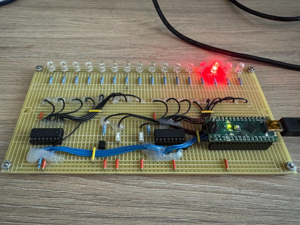

Below is a picture of the development board I created for my project, which utilizes an Arduino Nano. I want to do a kitchen timer with 16x LEDs and time intervals as below:

You haven't done anything wrong as such, you just forgot that the seven segment display is actually seven individual segments that are addressed. Each segment has a binary value associated with it so you are using 8-bits (0-7). You are counting upwards and the display is correctly representing the binary number.
Sending 0 (is actually 0000 0000) = all off
Sending 1 (0000 0001) = Segment A
Sending 3 (0000 0011) = Segement A and Segment B
Sending 16 (0001 0000) = Segment E
So if you increase your count to 255 you will scroll through all segments.
For your test you may want to create a loop, and in the loop increment a variable, then output the variable.
