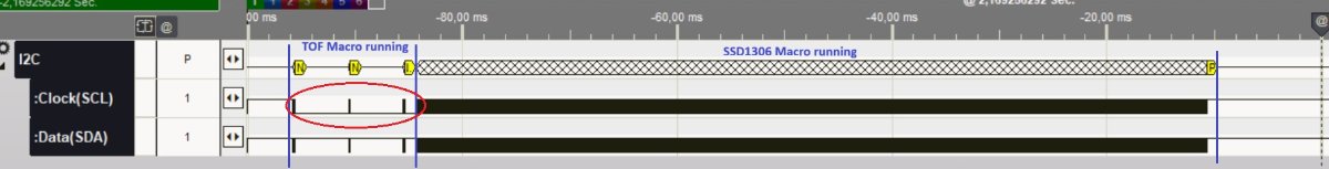

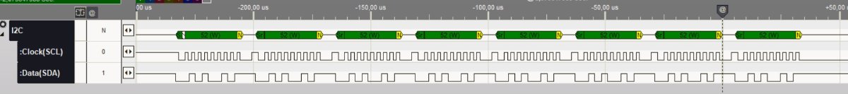

I am attaching two pictures of the issue.
TOF initialization does not happen at startup either, the MCU tries to program the sensor, but they "don't understand each other".
It would be great if you could find a solution to this error.
TOF SCL idle state is LOW.jpg (33.79 KiB) Viewed 5895 times
TOF SCL zoomed in on the first I2C data packet.jpg (33.09 KiB) Viewed 5895 times
Regards,
Sasi

Since both I2C channels are operational, I attempted to connect the sensor and the display to separate channels.
In this configuration, the TOF sensor functioned correctly. The SCL line remained in its expected idle high state.
(I re-tested the setup using a PIC16F18857 MCU, and observed the same malfunction when the display and sensor were connected to the same I2C bus. Therefore, this issue is not specific to the PIC18F27Q10 device. :oops: )
