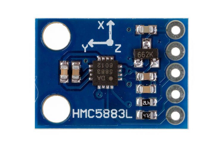

I startup with a new testprogram as you advice, strugling and figth and will sent you data from logic analyzer to you. The last ting I tryed, supply the device to 3,3V, and then data is comming data in the display. Nice so it work. ;)
But one thing, I guess that "use data pin is when the device is finish update data it give a signal out? I can enable and disable it, bur if I in config set it for yes, no data come out and if I use no, the the triggersignal is comming. Okay, the other way around is a trifle.
If someone like to test, I use the device on the picture, on the backside is label GY-273, the GY-271 will not work.
Again thank´s for your help.

The GY-273 first (which now vorking have adress: 0x0D
The GY-271 have another adress: 0x1E
So I guess this is the issue, but can´t see in proporties where to change it, maybe you could update so it is possible to choose in proporties? ;)
