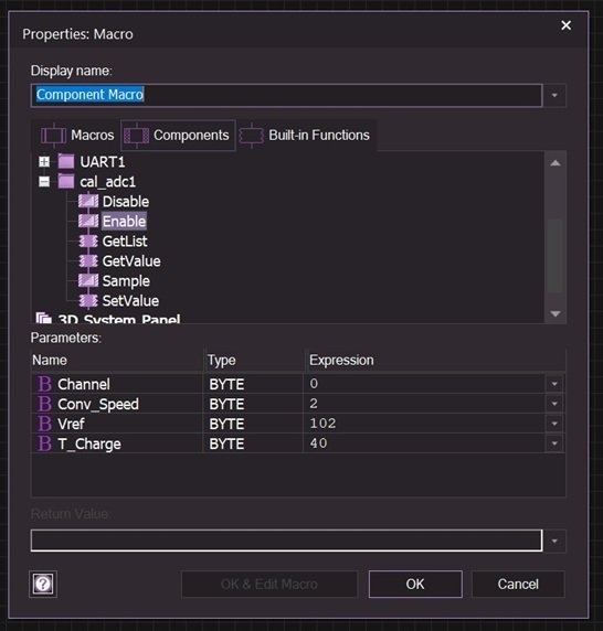

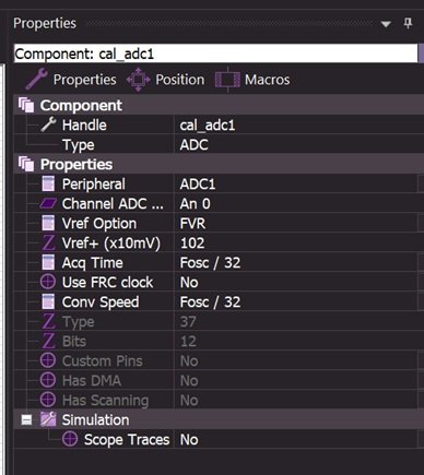

However, I’m a bit confused about how to properly configure it. Specifically:
  • In the ENABLE command, what value should I assign to the Conv_Speed parameter if I want the conversion clock to be, for example, Fosc/32?
  • The value of the "T_Charge" parameter must be given in microseconds, while in the Component Properties window this parameter is indicated as "Acq Time" and it seems to share the same list of selectable values as Conv_Speed. What value should I enter here?
I’ve spent an entire afternoon trying to get this component working, but so far without success.

If you double click the Acq time and Conv speed properties you can see the value associated for each of the items in the list.
The Vref parameter should be the Vref option and not the Vref+ 102 value you have there.

  • I found the ADC (CAL) component’s WIKI page a bit on the minimal side.
  • In the Properties window, the Acq Time dropdown shows the same values as the Conv Speed, which was a bit confusing.
    In some other ADC components (like the one used for the potentiometer), the acquisition time is set in microseconds instead.
  • Also, the same parameter seems to go by different names — in the Enable command it's T_Charge, in the Properties it's Acq Time, and in the potentiometer macro it’s called Acquisition Cycle.
    If all of these refer to the same thing, maybe it’d make sense to unify the naming a bit to avoid confusion.
