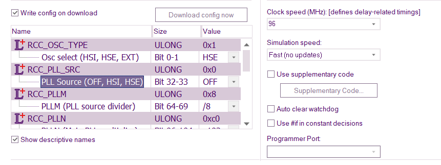

I’m encountering a strange issue with the UART baud rate, which I suspect might be a bug.
Everything works correctly at lower baud rates, but when I select 115200, the UART output becomes extremely slow — roughly equivalent to 110 baud or less.

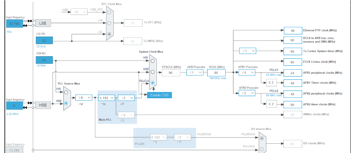

I’ve modified the FCDX file to allow the MCU to run at 96 MHz, and I’ve configured the RCC settings according to STM32CubeMX without any reported errors.
I’ve attached the modified FCDX file and a screenshot of the RCC settings for reference.
I am kind of stuck any help would be great :)
Cube RCC Settings.png (123.96 KiB) Viewed 3754 times
32F407ZG.fcdx
(69.54 KiB) Downloaded 194 times

I believe I’ve found the source of the problem.
I had to set RCC_PLL_SRC to OFF, as this was the only way the delay timings correctly matched 96 MHz when verified on the oscilloscope.
However, when I change the PLL source to HSE, the UART baud rate improves slightly, but it still doesn’t reach the correct speed — the issue remains.
So, the question is:
Is it possible to run the STM32 at 96 MHz without causing timing or UART issues in Flowcode?

However, I’ve noticed another problem: the timer interrupt frequency is being calculated incorrectly. The calculation is based on 8 MHz, but after the PLL -> APB1 ends up to be 48 MHz.
As a result, the interrupt frequency is calculated as 8.503 Hz, when in reality it should be 50.1 Hz.
