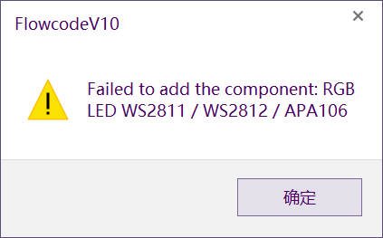

Hello, this error occurred after upgrading. What should I do,
In the first few days, after reporting to WS8211, I sent the file you posted on the forum( download/file.php?id=10494 )I copied and pasted it into% ProgramData% \ MatrixTSL \ FlowcodeV10 \ Components, and encountered the error after upgrading today. What should I do? Acknowledgments

The upgrade is proceeding normally, but when adding the ws8211 component after the upgrade, the above error message appears

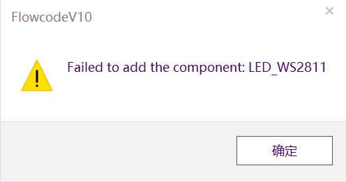

After deleting LEDw_S2811.fcpx and upgrading it again, the error shown in the above diagram still occurs。

After today's upgrade, ws2811 still has the above-mentioned issues.
