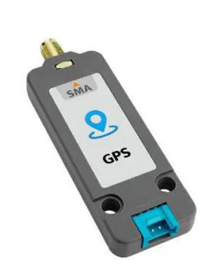

Would it be possible to create one or more components?
module with antenna connections.
https://eu.mouser.com/ProductDetail/M5S ... DyQw%3D%3D

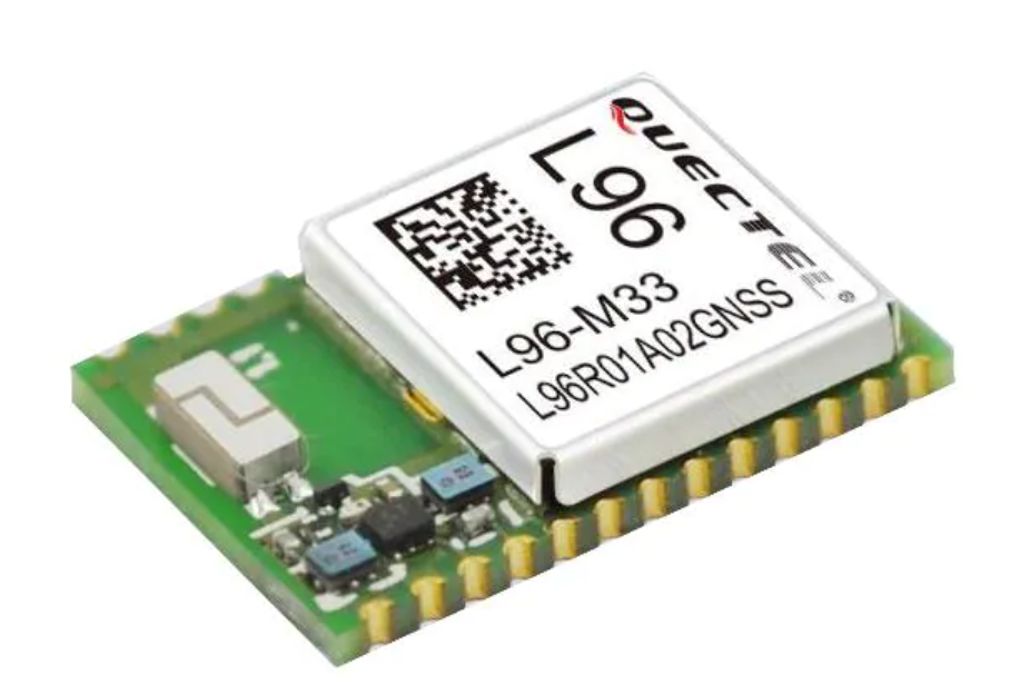

integrated circuits (just an example)
https://eu.mouser.com/ProductDetail/Que ... ecmQ%3D%3D
