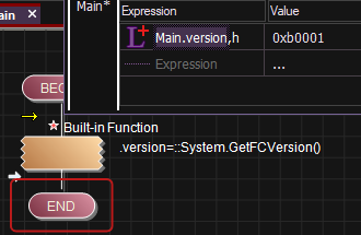

If you mean getting the Flowcode version, then the "GetFCVersion" function provides it. My debug build is showing 0x0B0001 which means v11.0.1 (treat the returned value as 0xAABBCC where the version is AA.BB.CC).

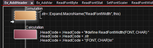

Ben is the master of this kind of thing, but I think you can use it in conjunction with the Ev_AddHeader event. This allows you to change or add to the C code generated for the component.
Here's a snippet from the GLCD_Base component:
Screenshot 2025-12-04 103037.png (25.91 KiB) Viewed 4975 times
In your case, you could potentially create a new function maybe something like this:
.HeadCode = .HeadCode + "int MyNewTransactionWrite(int NewParam1, char* NewParam2) \n"
.HeadCode = .HeadCode + "{\n"
.HeadCode = .HeadCode + "  //do something to create the actual params from those passed to this function\n"
.HeadCode = .HeadCode + "  MX_UINT8 myfont = 5;\n"
.HeadCode = .HeadCode + "  MX_UINT8 mychar = NewParam[2];\n"
.HeadCode = .HeadCode + "  " + .str + "(myfont, mychar);
.HeadCode = .HeadCode + "}\n"
And then call "MyNewTransactionWrite" from a C block. But you could possibly do this instead with a normal Flowcode macro, so I'm probably not fully understanding what you're trying to do.
