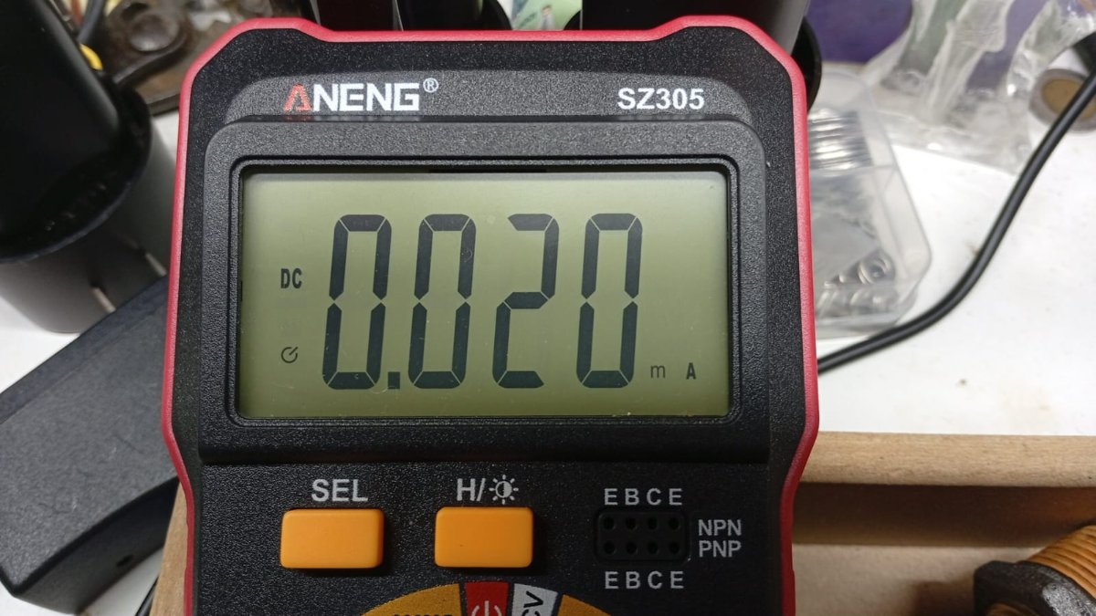

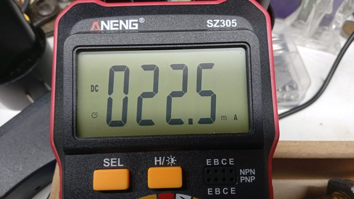

Continuing with the topic of the SLEEP, WDT, and CLRWDT commands, I'm using a PIC16F1939. It accesses the SLEEP command correctly, although sometimes it doesn't. Previously, I used a PIC16F1847, and SLEEP worked correctly there.
The problem is that the current draw suddenly changes from 0.020 mA to 25 mA after 2 or 3 SLEEP cycles. It starts at 0.020 mA and increases to 25 mA continuously.
This happens repeatedly, I've disconnected transistor outputs, grounded all unused pins, turned off the LCD, and used commands to disable PIC pins, but I can't get the current draw to remain constant while in SLEEP mode.
Initially, I even managed to get the selected outputs to activate correctly when the PIC woke up, and it would return to power-saving mode, but now, with all the changes and tests, it seems like I'm going backward instead of forward.
Could someone help me by taking a look at the flowchart?
I would appreciate any help. :)

I tested it using the relay as an indicator at the beginning of the program, and it doesn't restart from the start. It continues after SLEEP, and suddenly, randomly, the current draw rises to 25 mA and remains there until the PIC wakes up 256 seconds later, then drops to 0.020 mA. It consumes 0.020 mA most of the time.

It starts with a 16x2 LCD display and a 4x4 keypad to program, which I physically disconnect and add this parameter (LCDCONbits.LCDEN = 0;). When the main program routine starts, I convert pin of KEYPAD to GND outputs; and keep a DS1307 RTC in the main program routine, I power it with a BC548 transistor, read the hour, minute, and day clock, and disconnect I2C_MASTER1:STOP. I change the I2C port as inputs (set_bit(trisc, 3); set_bit(trisc, 4); I change the KEYPAD pins to GND outputs (0) and all unused PIC pins to GND outputs (0). With these parameters, I keeps current draw low from 0.020 mA in hours, but it suddenly changes to 24 mA during a 256-second SLEEP period and then drops back down to 0.020 mA for an undefined time.
Each time the PIC wakes up, it takes a reading from the RTC, increasing the current draw for a few milliseconds before immediately dropping back to 0.020 mA.
I think the sudden power consumption is caused by the RTC. As an observation, I'm using the DS1307 RTC reader program that Martin published in Flowcode 5 and adapted to Flowcode 10. Another detail is that I've connected the RTC to a PIC16F1847, and the SLEEP function works correctly. Another difference is that in that program, I don't connect the 16x2 display or the 4x4 keypad.
