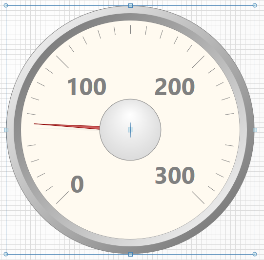

PC Developer:

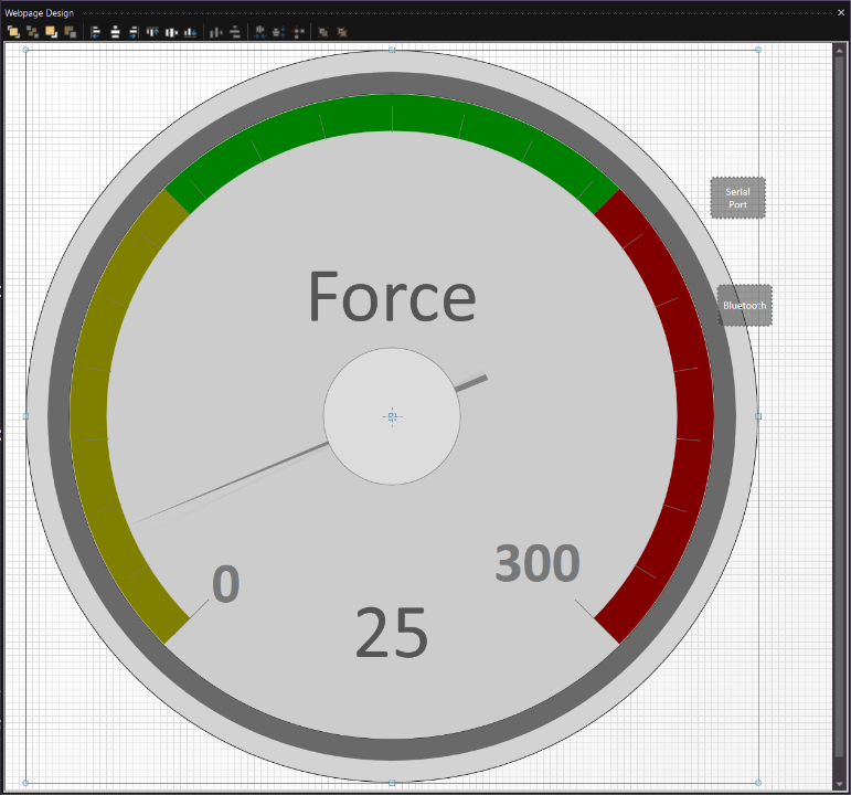

Web Developer:

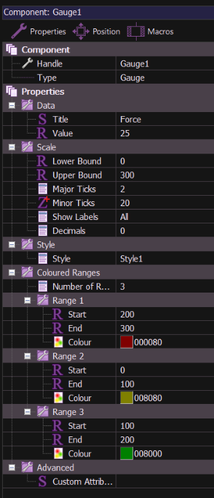

There is a hidden Gauge primitive available in Embedded and PC Developer modes which has a lot of options. This is used as the basis for the CircularGauge component (as well as a few of other components) and has many other features.
To add one, click the "Creation" component library on the menu whilst holding down the control key. You will now see a "Gauge" component there under "Primitives (2d)". Drag to add to your panel and you should have a load more additional options available.
This is an advanced feature and I would only recommend it gets used by experienced users (which is why it is a bit hidden).
For example, here's one that's heavily customised:

Re: AppDeveloper Gauge PC vs Web Developer
Hi Steve
Perfect!
You can do almost anything with this component.
