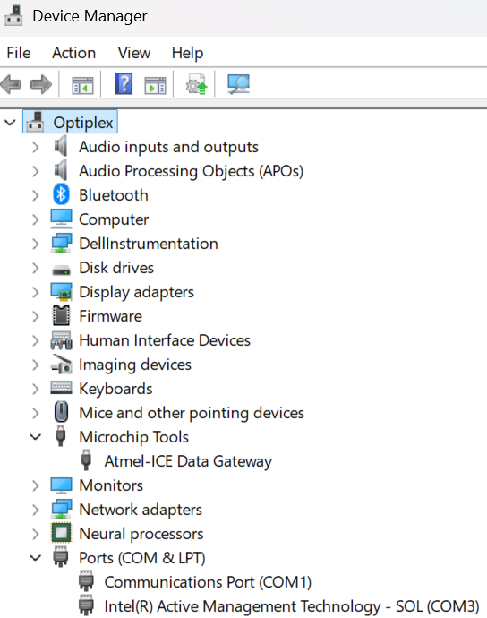

Re: ATMEL-ICE programmer not seen on "Programmer port" menu
I can see the programmer in Device Manager, and I have the latest drivers. See the first captured screenshot.
My problem is that I cannot see the programmer inside Flowcode, and I do not know how to configure it.

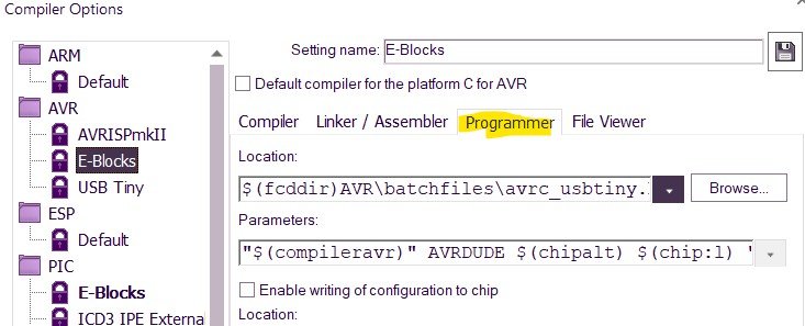

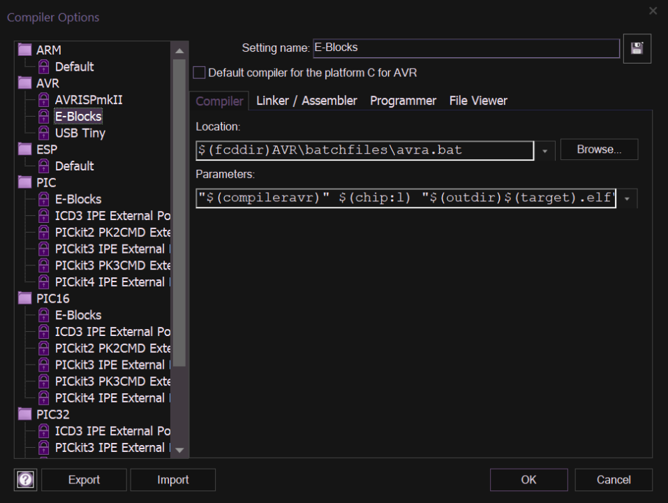

You have only given details of compiler in your screenshot, what is under Programmer? Is that set correctly?
Now I saw it... Which compiler should I choose for my programmer? And which programmer shall I use?
By default, when I was working with Arduino Nano, the AVRdude was the compiler.
I asssume you have downloaded the correct compiler for your chip from the FC website?
Although I have the compilers installed I don't have any external programmer for the targets, but these are my default settings which may or may not be of use.
Location is C:\ProgramData\MatrixTSL\FlowcodeV11\FCD\AVR\batchfiles (ProgramData is hidden by default)
