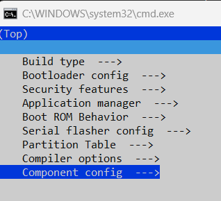

But I'm still having trouble with the configuration menu. I can't add the USB Tiny option in config-menue from Flowcode.

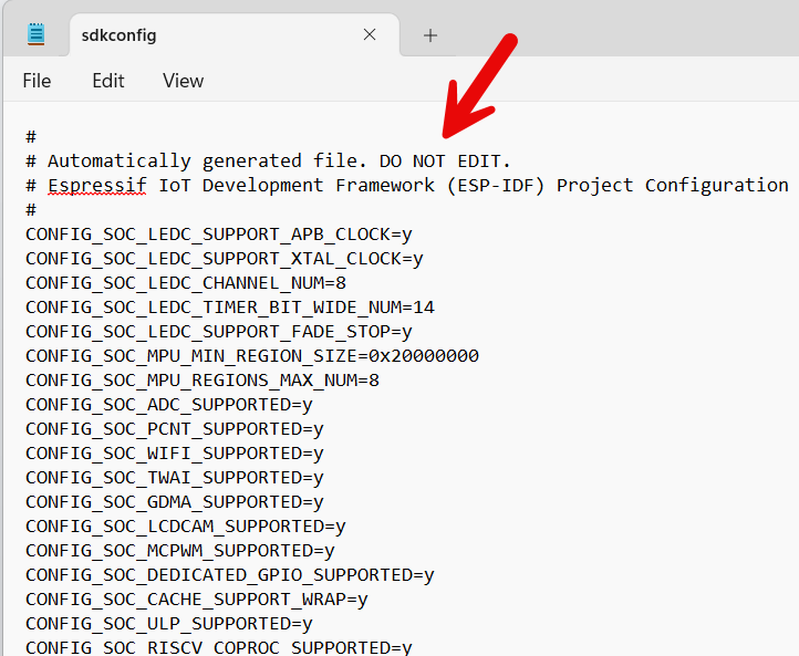

For a test; How can I insert these lines into the file so that it isn't overwritten?
CONFIG_TINYUSB_USE_INTERNAL_PHY = y
CONFIG_TINYUSB_INTERNAL_PHY_D+ = GPIO20
CONFIG_TINYUSB_INTERNAL_PHY_D- = GPIO19
sdkconfig file for esp32s3

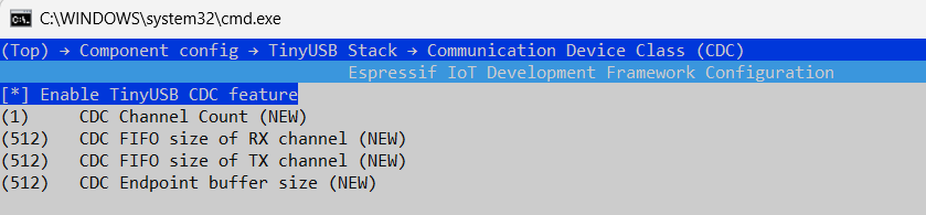

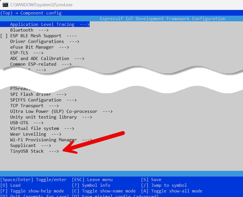

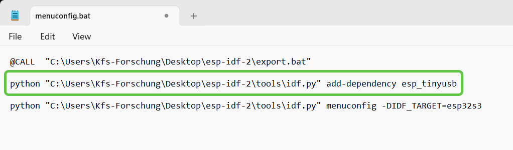

When I add the green line to the S3 menuconfig batch file, “TinyUSB” appears in the menu
@CALL "C:\Users\Kfs-Forschung\Desktop\esp-idf-2\export.bat"
python "C:\Users\Kfs-Forschung\Desktop\esp-idf-2\tools\idf.py" add-dependency esp_tinyusb
python "C:\Users\Kfs-Forschung\Desktop\esp-idf-2\tools\idf.py" menuconfig -DIDF_TARGET=esp32s3

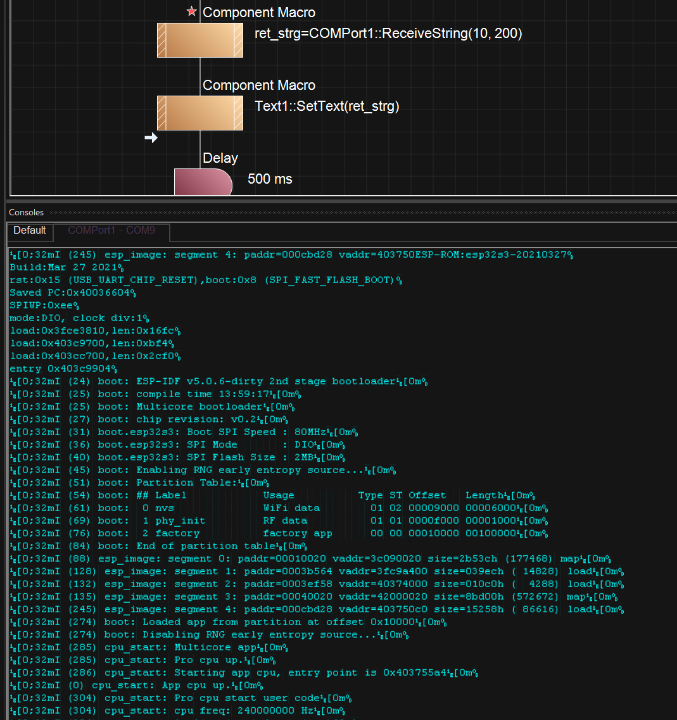

First, the good news. The code compiles and all the others functions still works fine.
But:
No, no data yet.
I still have one more thing to do.
In Flowcode esp32s3, there are only two COM ports. However, the S3 has three UARTs, and UART0 must be connected to this pin.
I'm not sure whether UART1 or UART0 is used in the Flowcode.
With channel1 there is no data output ....
UART0 is mapped to GPIO 43 (TX) and GPIO 44 (RX).

if I choose (X) USB Serial/JTAG Controller I get a lot in the console
