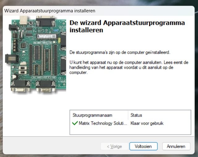

Hi there,
I have downloaded the drivers with the new link.
The driver (64 bits) is installed (pic 01) but the programmer doesn't show.
In properties, a strange symbol shows (pic-02).
What did I do wrong?
Rinie
Rinie

- Posts: 2061
- Has thanked: 311 times
- Been thanked: 479 times
Re: EB-006 drivers
The second image is showing that the driver was successfully installed, so it might be ok.
Is the EB006 showing in device manager? Mine is showing under "Universal Serial Bus devices".
