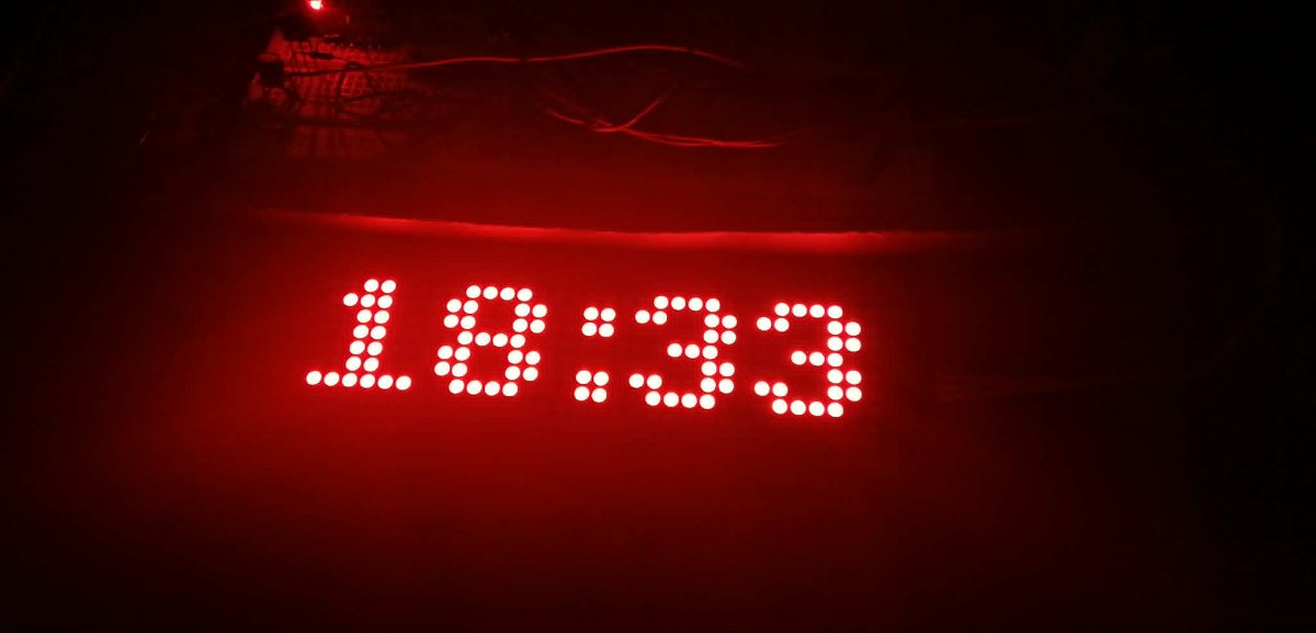

kaqkk007
Posts: 82
Joined: Sat Feb 04, 2023 1:09 pm
Has thanked: 4 times
Been thanked: 4 times
Re: MAX7219 32x32 LED Display
Post by kaqkk007 »
https://youtu.be/OYZQdaD63k8 Here's how the test version works
