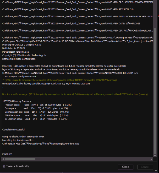

Re: Compiler ERROR PIC18F57Q84
I adjusted the register values in the project options. As you advised, I also used IntOscHelper to match the clock speed.
However, although I programmed it to repeat turning on and off every second, the signal is output once at the beginning, and the program does not execute.
I ask for your help.
Thank you.
Thank you.
