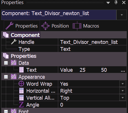

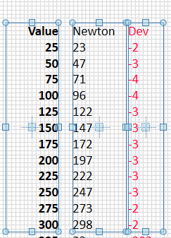

Maybe we could start by improving the text component.
The text component in addition to word wrap, set to small size and some space it create a nice colum
If the text component had "/r/n" for a new line it would be much easier.
And if the value could be copied with a single mouse click, it would also be useful for pasting the result into another Flowcode program.

If you have Word Wrap set to "No" then you can have "\r\n" in the text.

Ok It's working nice if I set Word Wrap set to "No" :)
Perhaps, when it comes to text, it would also be possible to have a "Get Text" macro similar to a "Set Text" macro?
And RTF test —it's works really well!
But it is a bit time-consuming.

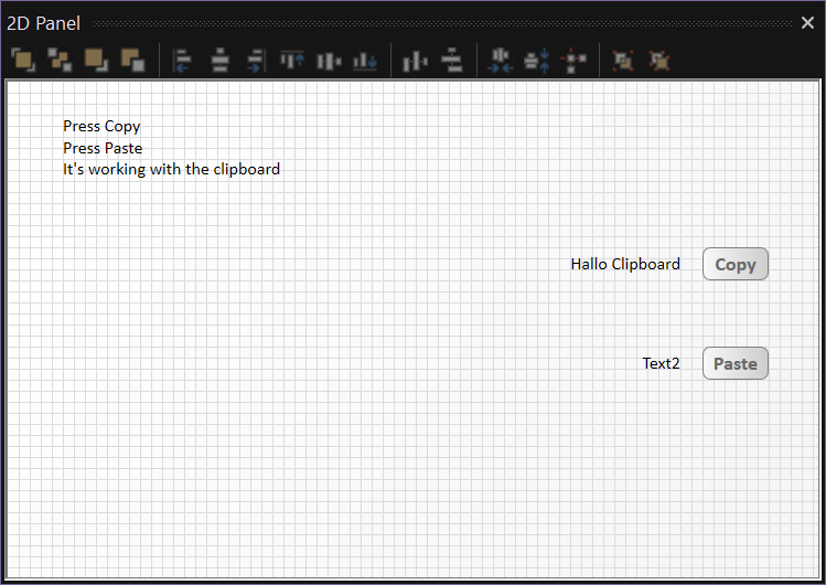

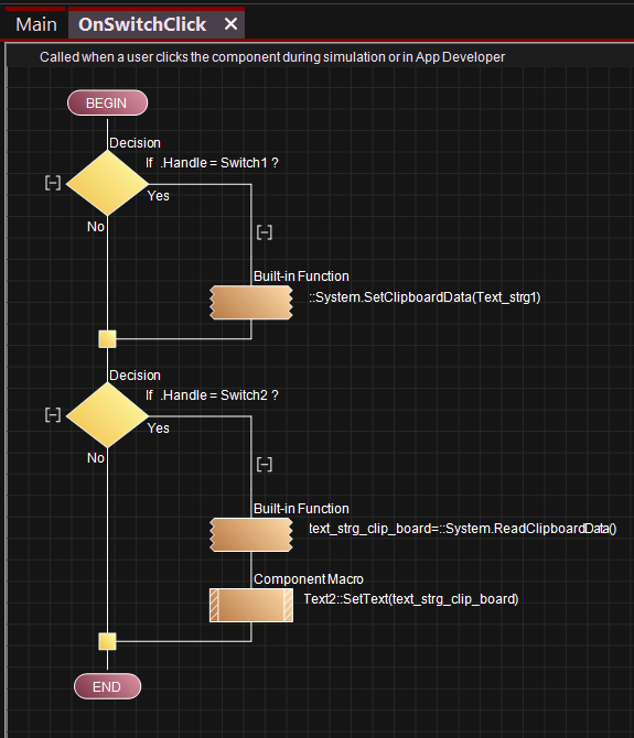

I've found a convenient way to use the clipboard with FC11
It can copy to the clipboard or retrieve items from the clipboard, including from other PC programs
ClipBoard_Demo_control_V.fcpcd
(18.29 KiB) Downloaded 77 times
