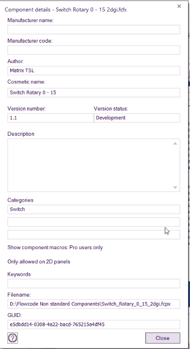

Flowcode v11 Re: Rotary switch
Hi Bob.
Best advice is to follow what Steve said & download the modified component and place it in a directory for any custom components.
For example I save custom components within a directory I added called D:\Flowcode Non standard Components.
I then add the directory within File > Global Settings..> Locations tab > Look for components in ..
After adding the folder location (note if you add a semicolon at the end of the directory path, sub folder will also be included), reload your project: File > Reload
You can tell if Flowcode is using the modified component by going to Component Libraries, right click on the component and select Details.
You can then see the folder the component is located:
Rotary switch modifed1.png (62.31 KiB) Viewed 2218 times
Look at Filename.

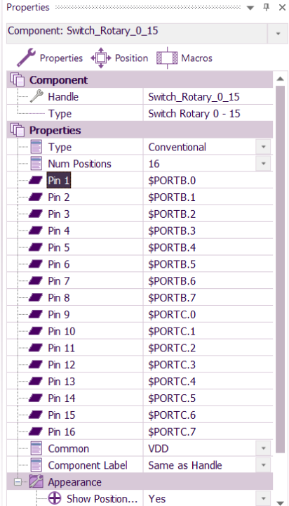

If you have downloaded the modified component and the path is correct then the properties for the convention switch settings will look like this:
Rotary switch modifed2.png (127.15 KiB) Viewed 2218 times
