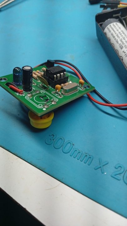

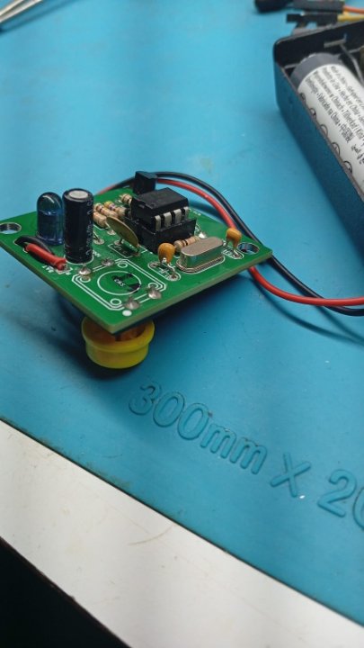

In fact, this circuit does much more than that and works correctly; these components are an addition to the circuit. I tried getting them to work by adding them, but since they didn't respond, I separated them from the main assembly. I want to get them working first so I can add them with the confidence that they function properly. I am keeping the PIC configuration the same so the components operate in the same environment. I think verifying that the components work individually is the best approach; once that is achieved, I can add them to the system. If they don't work then, I would suspect a timer conflict or some other issue, but at least I would be certain that the components themselves are working correctly.
I also performed the tests mentioned in points 1 and 2, and I ran the cell phone camera test as well; the IR LED is indeed transmitting a signal, but—as you said—I have no way of seeing it.

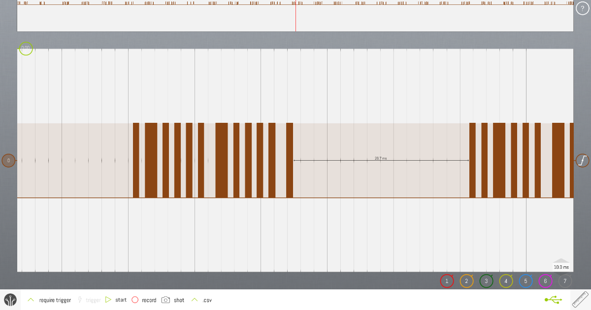

As I couldn't get the component to transmit - I modified my code above to the 12f1840 (**** actually 12LF1840 - you might need to change this).
This gave:
Note that one slight oddity - because the transmit is interrupt driven (and doesn't wait for completion at the moment) - the delay after the SendRC5 must be long enough for the transmission to complete. I used 50ms which gives ~25ms between transmissions - however the RC5 protocol requires more time than this to allow the AGC to cope!
The code uses two bits of C - one to enable a custom frequency for a carrier of 38kHz and one for a custom timer.
This gave:
