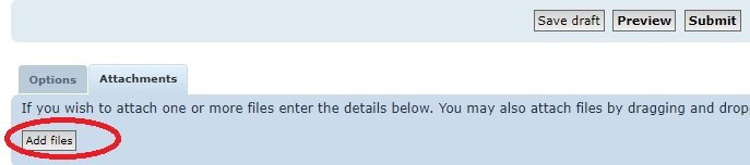

Please add your project file (ends in .fcfx) and the message log (ends in msg.txt) to your post
