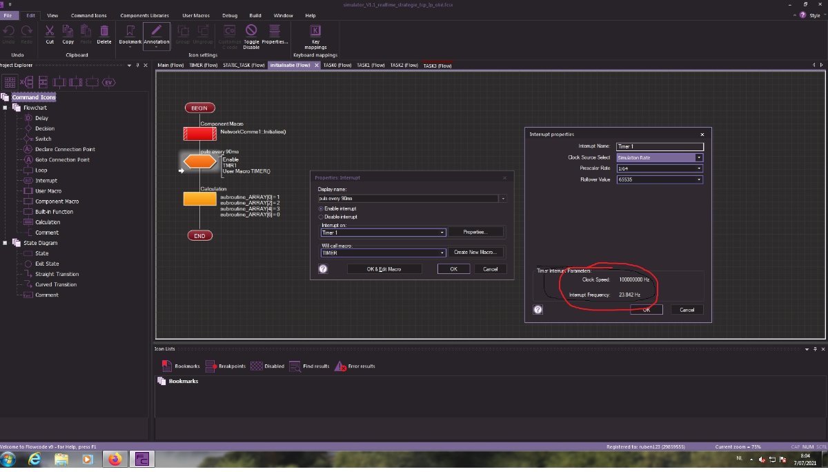

hi all
I finaly figuered
it out how to connect to different node's trough tcp/ip and make it look "realtime" i start from scratch again .
now every node has +/- 750ms to speak to the main PC that controls everything .
A question to the developers : when i use the timer interupt the given info about the frequentie isn't right ? i had to go on my feeling wich frequentie works for me becaus the highlighte frequentie doesn't match the real frequentie.
I finaly figuered
- timer_fout.jpg (106.47 KiB) Viewed 10434 times
- realtime_strategieV1.2.fcsx
- why doesn't match the freq given the "real" frequentie"
- (35.24 KiB) Downloaded 725 times
- (view online)

Re: how to connect to different node's trough tcp ip
Yes we are aware the simulated timer interrupt rate may be a bit off and one of our major goals for the next version is to try and improve this.
Well done on getting it working though and many thanks for sharing with us.

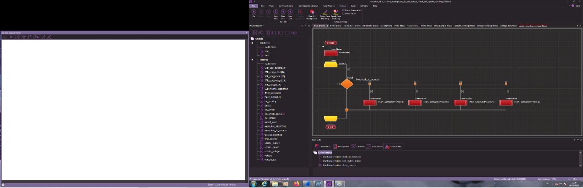

hi everybody
I encountered next probleme when running the flowchart in simulation my 2ddashboard ended up beining white
the only thing i can do then is close everything en start everything up again
thx again for your help guys
Greetings Ruben
Greetings Ruben
Hi.
I've tried simulating your program, but I've not been able to replicate the problem. Were you doing something particular when the error occurred or was there any error message reported?
