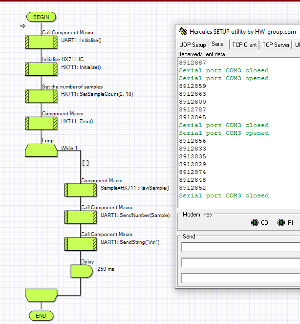

Re: HX711 zero
here is the code, and the results from UART.
Even if I put Macro "zero" in loop < while > then I get similar results like attached.
Thank you for help in advance.
BR,
BR,

Re: HX711 zero
Are you using the latest updates via the Help -> Library Updates window?
I've had a look through the HX711 code and it looks like the zeroing should be working fine. I'll run some tests here to double check.
Edit, I may have just spotted something, pushing it to the update system now.

Re: HX711 zero
it works OK! thank you for your great job!
I hope my topic related to BMP280 will be also solved soon
