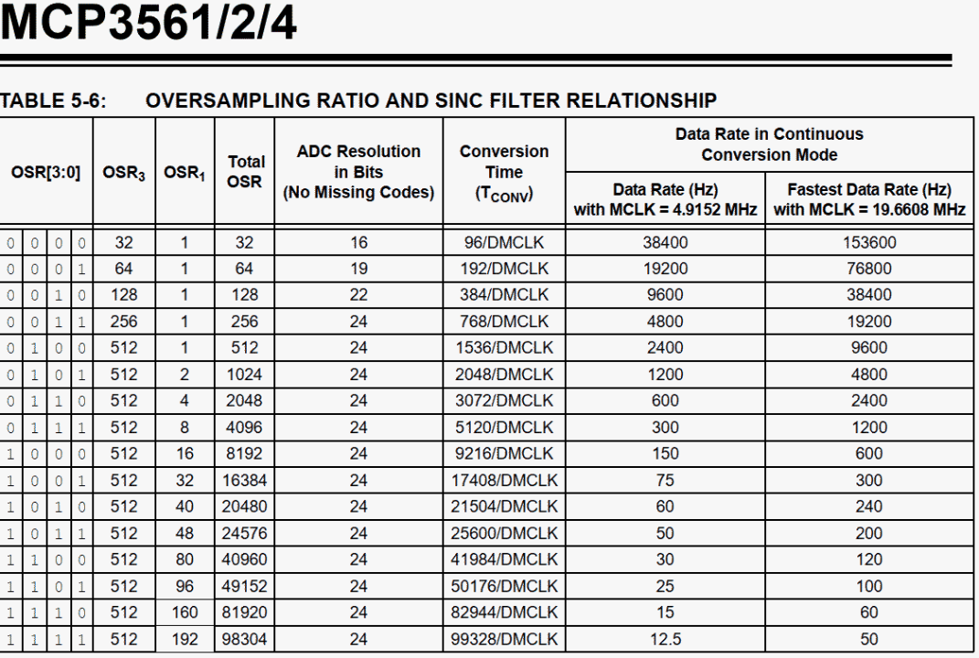

According to the specified range, the MCP356X should manage an OV of 2048 at 10SPS. see list 1024 is still running

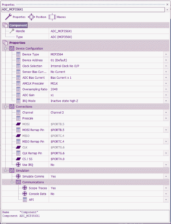

The input for the offset error and gain error function is not explained. What should be entered there and where do I get the values.
I even think that the chip calculates the values itself if you address the register in the chip correctly.
I can only use the possibilities of the chip to a limited extent with this library.
That's what I'm trying to say.
For example, if I want to use the possibility of oversambling, which the chip can do without further ado,
see the excerpt from the data sheet, in the properties of the library, I get stuck in the query of the input values from the chip. When I look at the transfers on the SPI lines, there are a lot of transfers or queries. I think that the chip is constantly being queried by the library to see if there is new data. Since I want to have a new value 10 times a second or even faster, the library is triggered again before it has determined that the chip is providing new data, the software hangs.

I have attached 2 programmes in the post with the name ADC 9 Click BEN_1 makes the image Ben1.PNG
ADC 9 Click SpeedPic32_1 makes the picture SpeedPic32_1
Ben_1 reads a value every 501 msec with 2048 oversampling ratio
SpeedPic32 read a value every 100 msec with 49152 oversampling ratio
