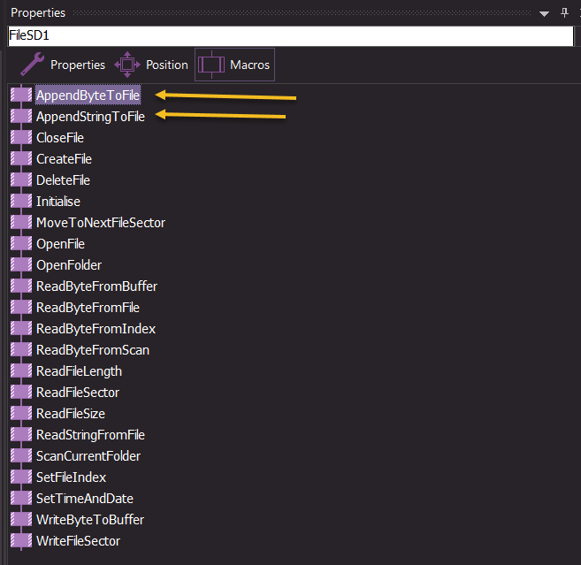

a simple way is with append

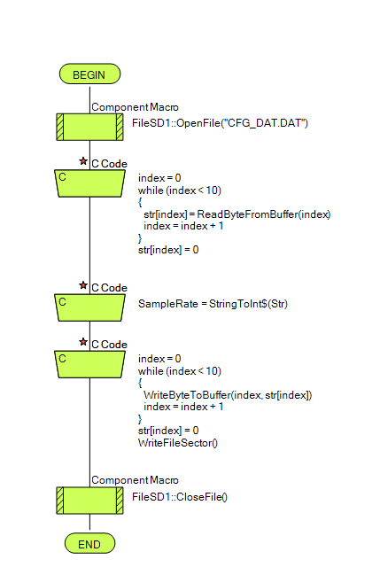

Hi Ben. So although i know c programming (somewhat) I'm not sure how to use this in flowcode. Is there tutorial available? I've looked and can't find anything with detail. I clearly cant just copy this and put it into a c code macro. Can variables declared in flowcode be accessed directly from a piece of c code or do they need to be declared in the block? Can you explain using your example?
Cheers
N
WingNut
Posts: 285
Has thanked: 54 times
Been thanked: 43 times
Re: Q about setPos
Post by WingNut »
Hi again Ben. The attached is what i understand but i know it doesn't work. Can you give me a pointer?
