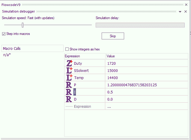

I have played a little bit more.
I get my values transferred to the pid.
I simply turn 300.52°C into 30052 Ulong.
the output of the pid is then Uint to 65535
I can take over the P,I,D data as it is.
One question remains: What happens to the Sample Time value?
under Properties:
Ti must be called integration factor
Td must be called derivative factor
Both times a factor is entered and no time.
The time is added by the loop time in the example 100ms.
When I use DSP input ADC in the simulation, I have noticed that the display does not fit in the 2D dashboard:
in the 2D Dashboard the display does not match the variable and the PIC ADC.
First of all, the value under chr must not go up to 256, then it becomes 0 again.
under UInt 1023 is displayed but a scale up to 65536 must be displayed on 1023
under int only 1023 is output with a wrong scale +-32768 should be set to +-511
both long are also not correct with this PIC as well as float on 65536/65535
under Properties:
