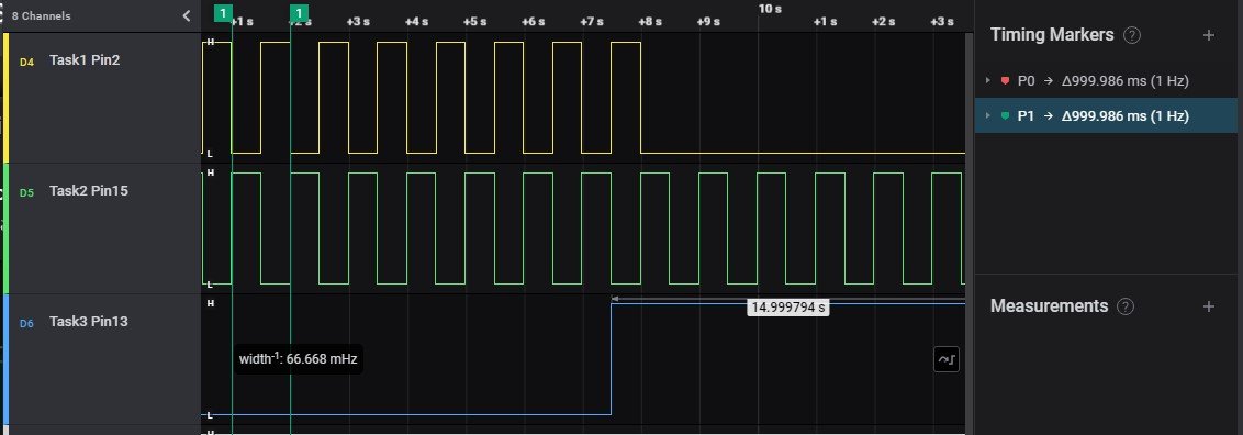

Small prog who is using XtaskcreatePinnedTocore to start task on specified Core with priorities
Main task will start the Tasks then task will restart automatically with a vTaskDelayUntil specified.
Xtask.fcfx
(27.74 KiB) Downloaded 666 times
