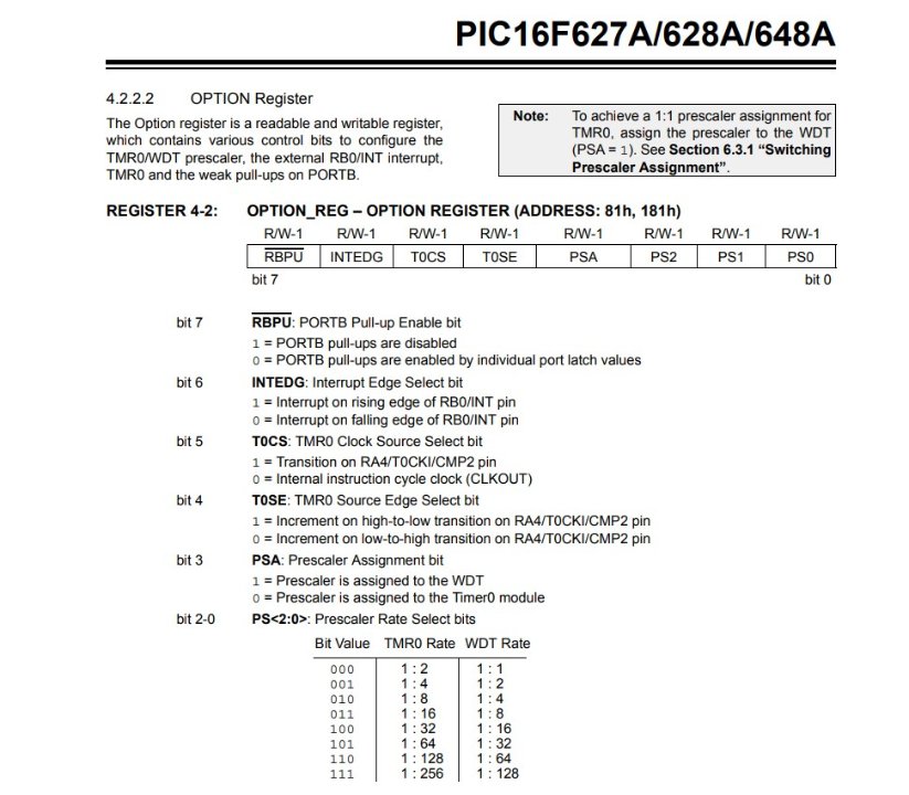

what I posted was a link to a guide to point you in the right direction of how to use C code.
It will vary depending on the target.
In your case of the 16F627A the datasheet shows:
So instead of
OPTION_REGbits.nWPUEN = 1;
you will need to use
OPTION_REGbits.nRBPU = 1;

Yes many thanks Martin,
with RPBU it is working!!! :D
