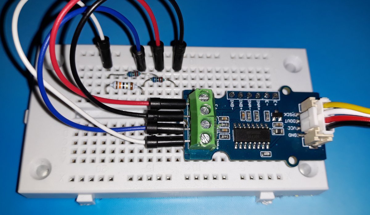

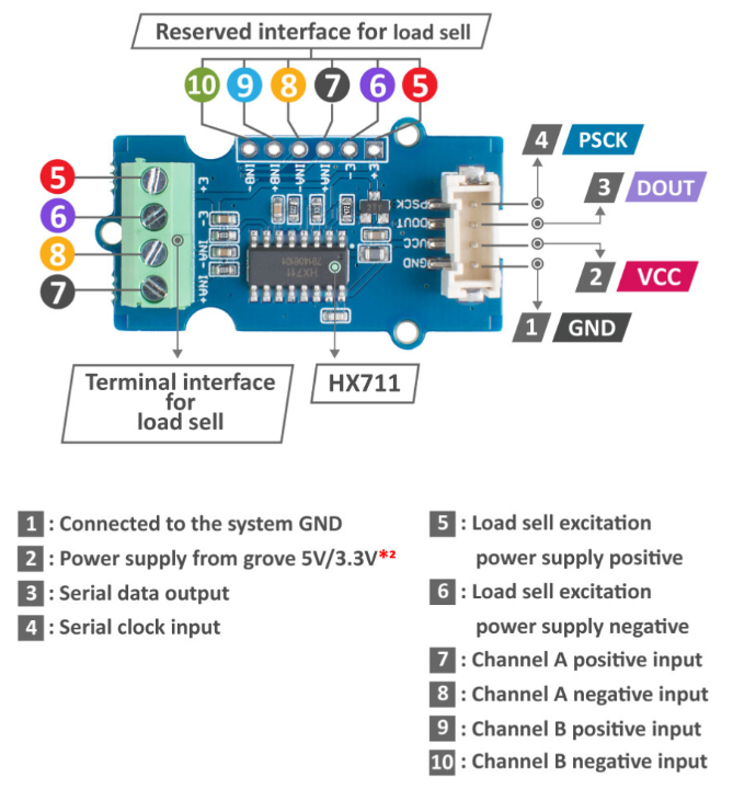

On the extern grove connector from the M5StickCplus I connected the Grove - ADC for Load Cell a HX711 and used the component from FC9, but this will not work! It shows always 0.
in the simulation it's working fine.
I tested both signal, the clock and data pin with my oscilloscope . Some signal are changing on these 2 pins and looks ok

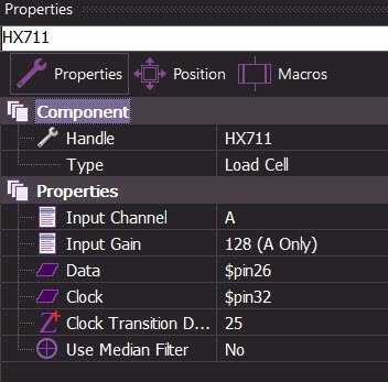

What about the "ClockDelay" ? Is this a problem? I tried few but always 0

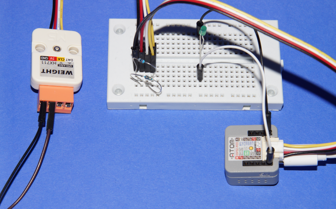

Changed the ESP32 board from the M5stickCplus to the M5 Atom and the HX711 Board from Seeed-grove to the original M5 Board.
Send the value via USB to the computer, the ESP32 Atom is sending 8388608 all the time.
I tested with and without pull up and testet with the osciloscope on the pins, The pins have a signal.

After a component library update from ESP32, the HX711 now works on an M5 Atom board.
I use Data=G26 Clock=G32 for the intended 4-pin Grove connector.

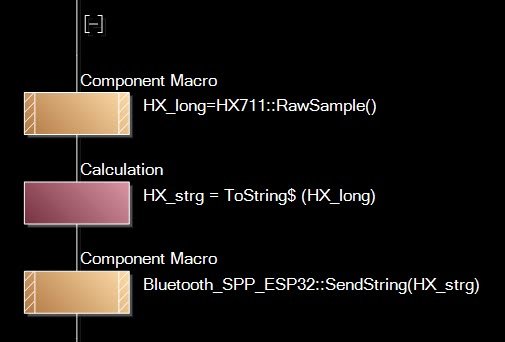

Sending the measured values with Bluetooth is very convenient.See picture Hx send.
