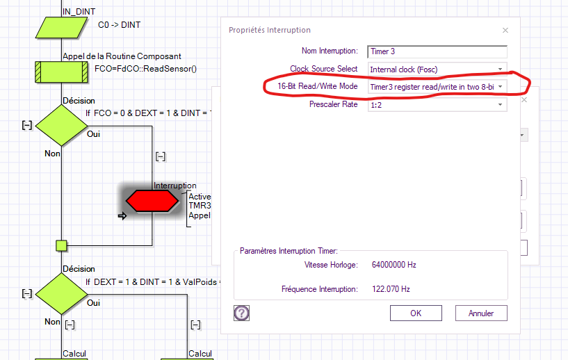

Re: Problem with Timer
Hi Martin,
I just modified the timer configuration (see circled in red) and it works.
"Timer 3 register read/write in one 16 bit" to "Timer 3 register read/write in two 8 bit"
A great thank
Luc
