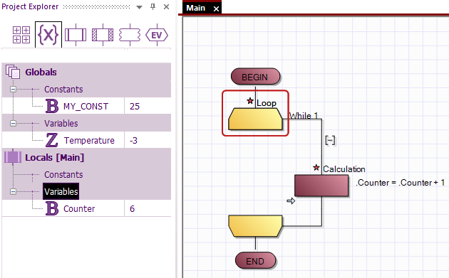

I agree that this would be a useful feature. In fact, we're ahead of you and have already implemented this as a new feature of Flowcode v10.
As Kersing and Chipfryer27 have said, Flowcode v9 is perfectly usable without it but it is a really nice addition in v10.
Here's a screenshot of this new feature in v10:

Will we have an option on how this data
is presented (hex, bin, ... ) ?

Yes. Currently in v9 (and v10) you can add a suffix to the expression in the watch window to change it's format. See this post for more details.
In v10, I plan to add a right-click menu to specify the format.
