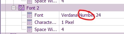

The display fonts in the display components have a few fonts that only show numbers.
Is it possible to add a comma or a point to these "number fonts" so they could show a float-like number?
Thanks..
Floats as "number font" on display

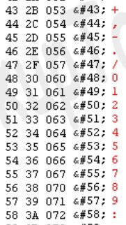

The Calibri Black Number and Fixed Number fonts include ASCII 43 to ASCII 58 and so should allow you , and . characters, looks like it's just the Verdana Number font that's more limited at ASCII 48 to ASCII 58.
I'll have a look and see how easy it would be to add the extra characters

I've had a go and pushed a new version of the font component to the library update system, hopefully Verdana Number should now have all the characters shown above to match the other Number fonts.
