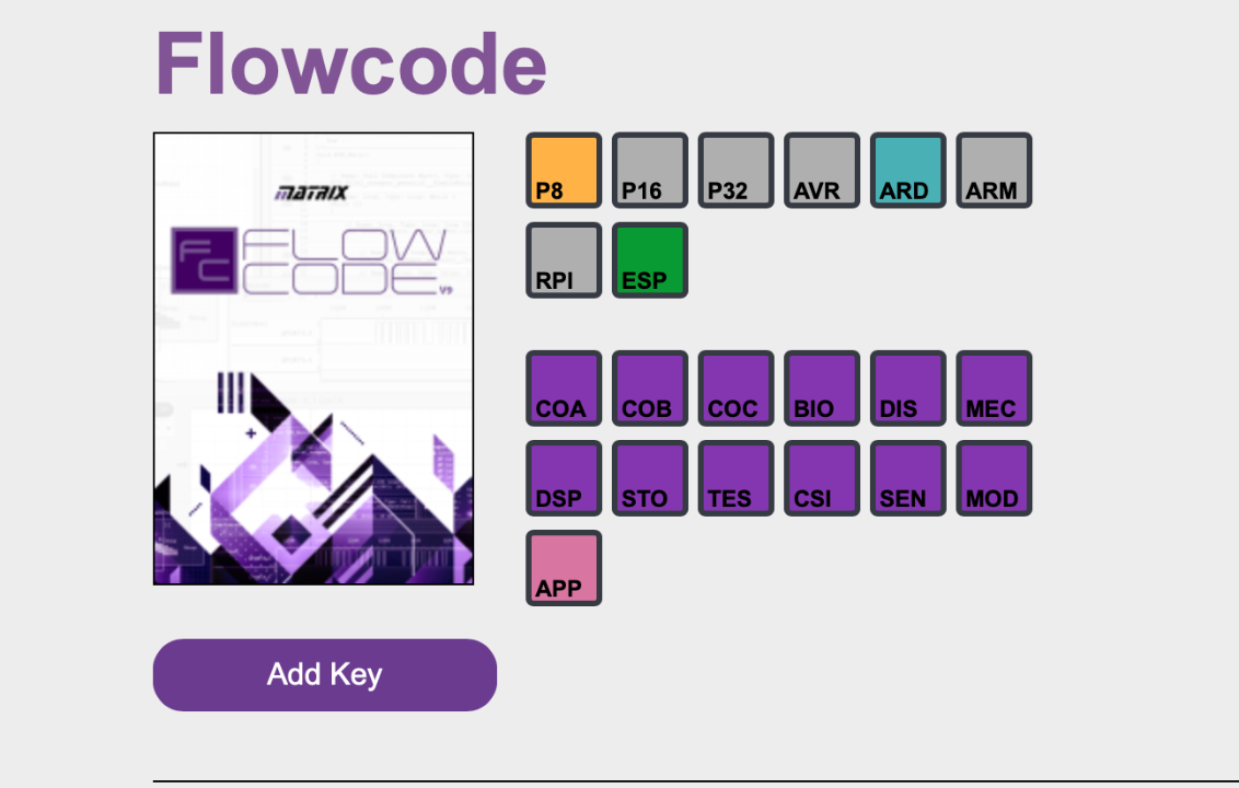

Morning - Why are we getting this message when we have the features enabled ???? Thanks in advance
Screenshot 2022-08-05 at 11.15.43.png (184.89 KiB) Viewed 2089 times
Screenshot 2022-08-05 at 10.36.05.png (132.33 KiB) Viewed 2089 times
Screenshot 2022-08-05 at 10.29.41.png (31.26 KiB) Viewed 2089 times

Which chip are you using? You will see that message if you are attempting to create C code when the chip target is not licensed.
