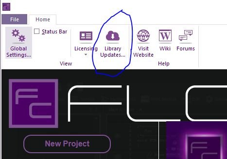

Never mind - found the library update under help - there was only one update available, but it was called 'switches'. Downloaded that and the switches work as expected now.

When you first start FC you will see an Icon in the top ribbon that states Library Update. Click this then ensure Full Database is selected.
