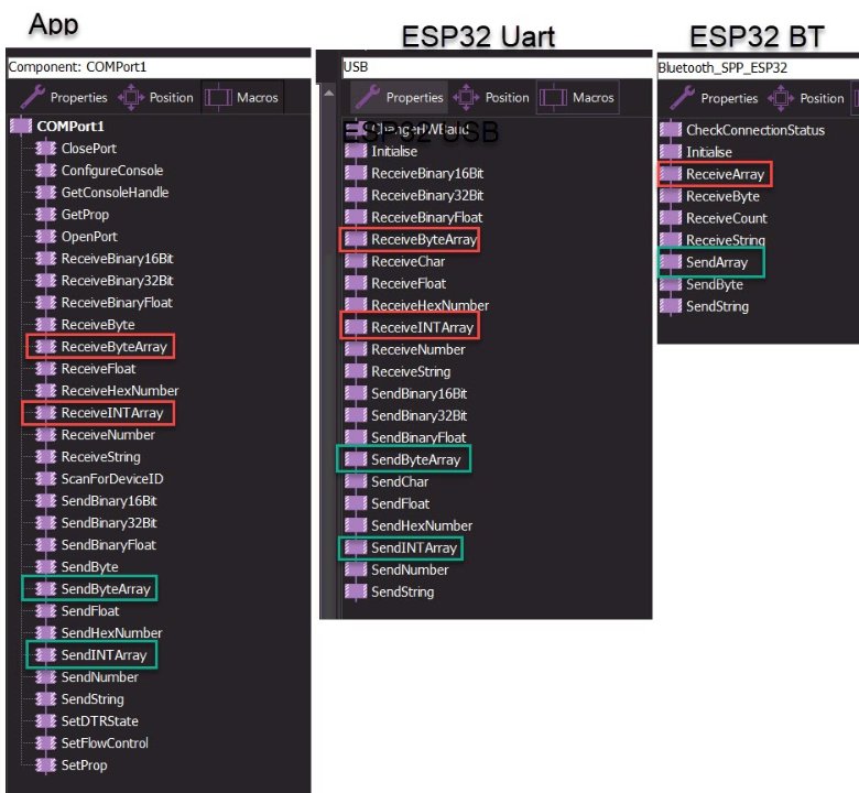

Re: ESP32 add more commands for Bluetooth
On various projects I have to use 24Bit data. This is not supportet in FC but 32Bit is very well supported. So I will use 32bit instead of 24bit
But not yet the 32-bit (Long) data transmission as Array in AppDeveloper comport, ESP32-Uart and ESP32-BT
Would it be possible to add this command as well:
ReceiveLongArray and SendLongArray
Maybe it would be possible to add this command for the ESP32-BT so the commands are the same.
ReceiveByteArray and SendByteArray
ReceiveIntArray and SendIntArray
The ESP SendArray already exists, you could leave it there so that old programs still work, but you know better than me how to do it.
overview commands
overview commands

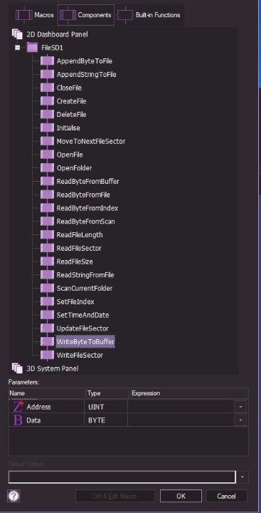

I mean these are just suggestions....
There is still a small improvements possible.
To write data to an SD disc relatively quickly, you can fill the buffer and write all at once. But buffer is only possible to fill per byte.
Couldn't this buffer also be filled with an integer? 256 integer will fill 512Byte.....
Could I make the USB/Bluetooth transmit aaray (buffer) to 256x integer and then write it to the sd card right away?
The other little problem.... I need to filter all integers with the DSP component.
I don't know yet whether in the ESP32 program or in the FC9 App or in both. In an array there will be 9 axes per sensor and there will be two sensors.
So 18 integers every 100Hz
All go through a DSP filter but not to the same filter. Once Kalmann, once low pass, possibly also a high pass
There could also be a DSP Component "IMU" where I read in all 9 axes and the DSP Component "IMU" gives me the roll pitch and yaw filtered......
(in the future)
SD Card
(in the future)
SD Card

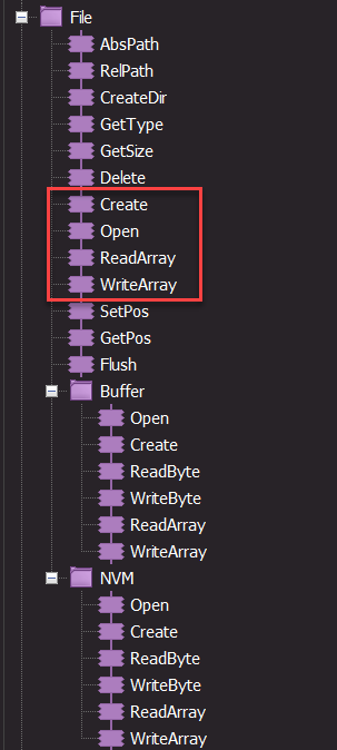

For file write/read I'm trying to use the app developer with built-in function File to write array and read it again as a simulationdata.
So I will create a movement file and read it again.
I chose the name "IMU.FMV".
Flowcode MoVment file
Also the 18 DSP filters with input output are much easier to create than I thought.
built-in function File in FC AppDevelopper
Yes that would be a possibility. At the moment I'm still using the USB. Maybe Ben will still add this to BT.

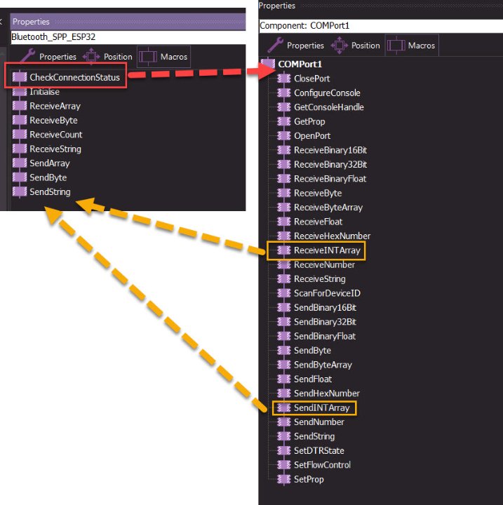

The use of ESP32 Bluetooth together with the APP developer is very easy, fast and a stable connection.
But two tiny wishes. With the ESP32 the sending (perhaps also receiving) of INTArray and with the App Developer a command like checkConnectionStatus.
Would this be possible to add?
Compare both commands ESP32 BT and APP developer comport:
- Posts: 2309
- Has thanked: 642 times
- Been thanked: 850 times
Sorry I know this one has been on the request list for a while. I've added the INT array functions for you now and am interested as to how you get on with them.
As for the check connection status function this is tricky, I don't think Windows itself manages this one very well but I could be wrong. The way I do it is I put a simple comms check into the firmware, so for example the App sends out a specific combination of bytes, the embedded side checks for this and replies. If the reply doesn't come then the comms channel is assumed dead, the COM port is closed and the app stopped with an error message.
