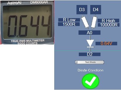

A diode test has been add and I'm pleased with the results: For the diode test to be accurate you will need to click on an empty space on the 2D panel and enter the voltage you measure for the +5V of Arduino Uno.
Also enter the series value of high and low resistors: Before loading the App Developer, make sure your Uno is plugged in.
Then check on the above properties that your resistor values and pin designation are correct and select correct com port for your Uno.

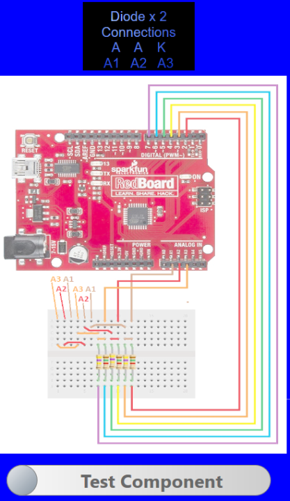

To up the game, I have modified the component tester so it now has three connections instead of two:
I'm working on a transistor tester which will identify a PNP/NPN transistor and will identify which lead of transistor is connected to A1, A2 & A3
Does not matter which leads connect to what connection.
Currently only the diode function has been implemented.
It's at the stage where one or two diodes can be connected to any pin anyway around (except in parallel), then the lead connections are displayed.
For example I have just connected two diodes up.
Anode on A1, anode on A2, both cathodes on A3.
The automated result can be seen on the above image.

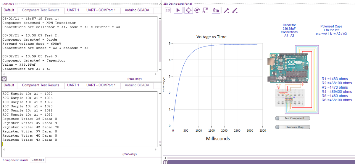

It even tests your hardware for you: There is a console window for logs of tests carried out: Bipolar transistors NPN & PNP (can connect any lead to any connection)
Single diode
Dual diode.
Resistors
capacitors

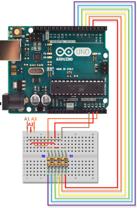

Within Image of properties Select the down arrow, and browse to the attached Arduino & Breadboard3.png
This will also contain the circuit diagram for the additional 6 resistors.

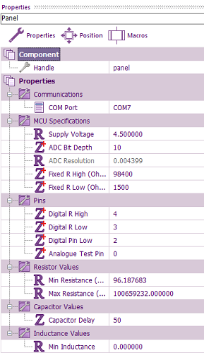

Try and match the resistors shown.
Measure each resistor then enter values on the properties of the 2D panel
Also within 2D panel properties you will need to select the correct comport for the Arduino UNO.

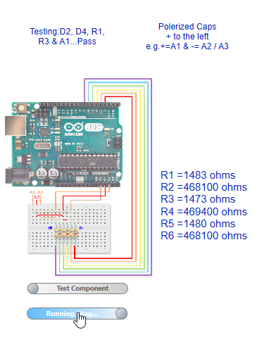

Test hardware by linking A1, A2 & A3 together
Click on Hardware Diag.
If hardware is ok (will not test for wrong entered resistor values) the app developer will return to the main starting point.
If there is an issue with hardware, then testing will halt for you to correct the issues indicated.
Single diode
Dual diode.
Resistors
capacitors
You will need to select the Hardware Diag button again.
