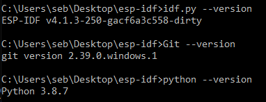

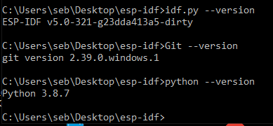

To check idf,Git and python version
idf.py --version
git --version
python -–version
