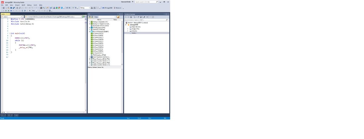

I am using arduino mega 2560 board.
microchip studio everything works correctly

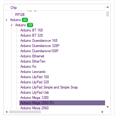

As you are using the Arduino Mega 2560 board, just select Build>Project options.
Right-click on any target and select search.
Enter mega 2560 for the search term.
Alternatively, you can just select the Mega250 from the Arduino range of devices:
Arduino Range.png (14.55 KiB) Viewed 7124 times
There will be no need to change the configuration settings as everything is preset.
Flowcode will program the Arduino board directly via USB lead.
No external programmer is required.

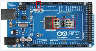

this one through the isp port I upload the firmware hex file

If I was you I would restore the bootloader and then only program via the USB connector and not via ISP.
This might help?
