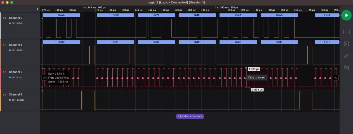

Yesterday, with your help, I tested it.
I initialized the PC, installed FC10 and updated.
However, MODBUS/TCP still doesn't work.
Upload the project file and logic analyzer screen here.
It may be difficult, but please take a look.

- Screen.jpg (74.57 KiB) Viewed 3477 times

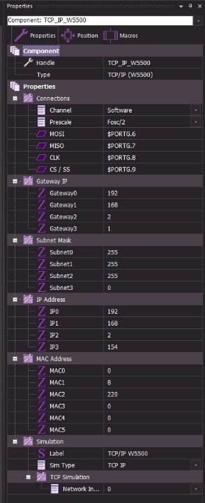

Can you try and increase the SPI prescale for the TXP_IP component, things weren't working for me when I had this set too low. 250KHz clock seems like it should be ok.
Might also be worth trying a hardware SPI channel if available.
Might also be worth doing a flasher test to confirm the MCU is running at the speed you think it is.

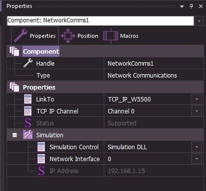

Re: Modbus / TCP Error
I tried changing the SPI Prescale. But the clock rate doesn't change and the error still occurs.

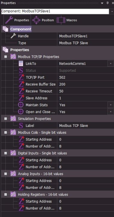

- Screen3.jpg (51.24 KiB) Viewed 3429 times
- Screen2.jpg (34.69 KiB) Viewed 3429 times
- Screen1.jpg (42.39 KiB) Viewed 3429 times
For the TCP_IP_W5500 component try switching to a hardware channel and also change the Fosc/2 to something more like Fosc/16 or /32 or /64
For me /4 wasn't working but as soon as I went to /16 it all worked flawlessly.
Everything else looks to be ok.
