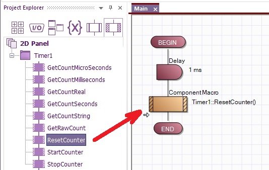

1) Help -> Library Updates
2) Add a Timer component macro to your project
Note: Timer component is not needed for simple Delay icon.

In both programs you posted you are not calling any of the component macros of the timer component. This as I said is problematic.
As you're not calling any of the component macros that can cause problems in the code generation.

You could do with exploring the Help -> Wiki -> Components search
Then ensure you have set the component properties.
For example, for the TimedInterval component you need to set a callback macro (that runs at the timed interval)
