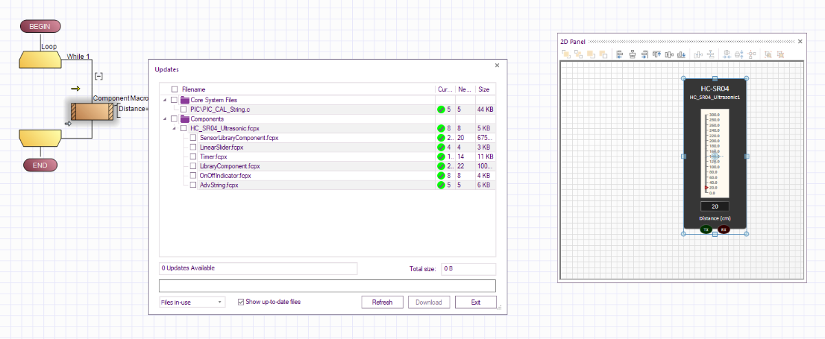

That still looks like the old version and not the latest?
Can you go to Library updates and select Show up-to-date files and what version does it show for HC_SR04_Ultrasonic.fcpx?

Hi.
That tells me I was correct.
When you add the fixed component to
%ProgramData%\MatrixTSL\FlowcodeV10\Components
What you should see is:
unoffical updates.png (4.21 KiB) Viewed 7209 times
Since it's not an official library update.
Did you restart Flowcode or reload your project.
Don't click on the Download after adding the unofficial component update.

Martin, I had click update during earlier part.
Since your last message, I follow on to that Now I got it to work.
Thanks, Alot :D
