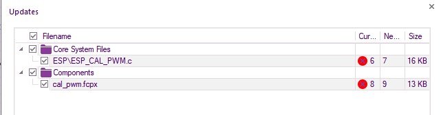

but when I check for update, the component new version is cal_pwm.
