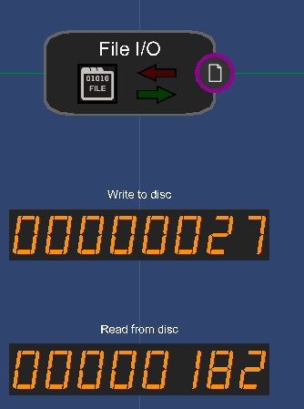

On my computer the time to write is between 16 to 28 seconds
I I have expanded the test with read back the written file. Unfortunately, this takes a lot longer to read as to write.
Can you have a look if you can put the turbo also for read?
FC9_APP_Speedtest_rw.fcsx
