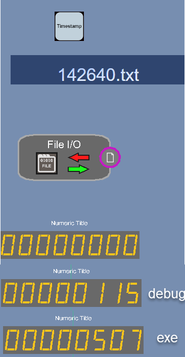

I wrote a little App for a speedtest for the disk
and tested debug mode and exe mod.
writing Total (51,200,000 bytes)
In debug it's need 115 Sec for 50Mega file = 434kByte/sec
In exe it's need 507 Sec for 50Mega file = 98kByte/sec

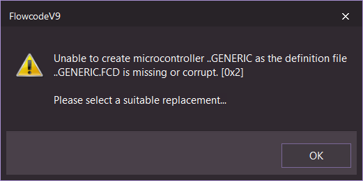

Then later I get an error while opening the App again.
I don't need the App anymore but it's strange
App Developer File write speedtest 50 Megabyte

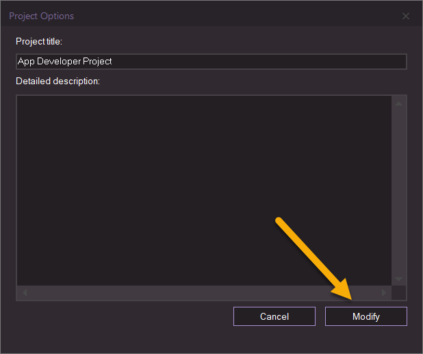

Re: App Developer File write speedtest 50 Megabyte
Does this fix the problem?
Not sure what's causing this but please let us know if it happens again.
but if I press this button I have again the error.

Hi Stefan,
Your project is a great benchmark for testing the write speed. I've got some ideas for speeding it up but I will try and tread very carefully to avoid creating any new bugs.
My current time to run your project is 281, though your recording of time passing might not be accurate as the calculations don't quite look right. at the moment 1 minute would equal 100 seconds. I'll see if I can refactor it to be a true representation in seconds.
I'll let you know how I'm getting on.
edit - I've refactored the calculations and the time for me to run the test is now around 148 seconds so this is my new benchmark to beat.

Now I get for 50 Mega:
23 Sec in App Simulation = 2.7Mega/Sec
85 Sec in App deploy = 0.588 Mega/Sec
0.125Sec in Matlab = 400Mega/Sec
At the moment i can live with 2.7 mega per second. That is a big improvement and a useful value.
