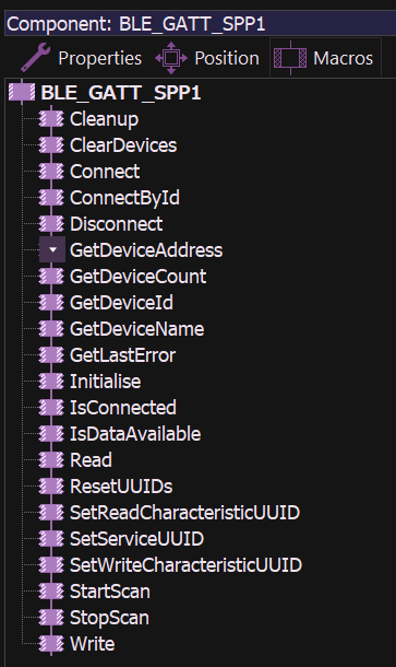

For PC developer, this afternoon I've written a DLL to interface the Windows Bluetooth API (will need at least Win10 for this to work) and I've written a component to go around this. Just need to test it all works now. Hopefully later today or tomorrow we will have something I can share.
Posts: 2305
Has thanked: 637 times
Been thanked: 847 times
Re: FC11 ESP32-S3 BLE error
Right this is largely working for me now but it needs more work to make it a bit more user friendly in terms of the usual read/write functions.
First you need the DLL which needs to be extracted and placed here:
C:\Program Files (x86)\Flowcode v11\API.DLL folder.
BLE_SPP_DLL.zip
(101.93 KiB) Downloaded 438 times
Next you need the BLE component. Here is the exported component file that needs to live here:
C:\ProgramData\MatrixTSL\FlowcodeV11\Components
BLE_GATT_SPP.fcpx
(3.05 KiB) Downloaded 444 times
Lastly here is the component source code, it has a little code in the main as a basic test I've been trying out.
BLE GATT SPP.fcpcd
(44.2 KiB) Downloaded 447 times
Let me know how you get on.

BLE also works with the App Developer now. Perfect!
Running a scan and selecting the right module with the address is also perfect.
Sending and receiving in both directions is perfect!
I will also test with the web developer.

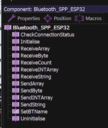

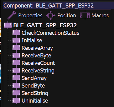

I can already work with read and write buffers, but it would be nice if BLE ESP32 and BLE App could read/write in the same style. I mean read/write string, byte, array, int array :) that would be easier for me and others.
Here is an example from the ESP32 SPP.
for comparison:

Right should all be available for you now via the library updates.
You will need a new version of the DLL for the PC Developer BLE component which now tells you how many bytes are in the receive queue rather then just a true/false.
