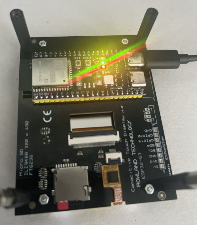

I'm not exactly sure what I'm doing wrong.
It worked with the ESP32-wroom. With the ESP32-S3,
I can't get it to work. I've already tried three different boards.
I also noticed that the green LED is flashing.
That happened with the SparkFun board, too.

I wonder if the LED is interfering with the signal e.g. adding capacitance and stopping the signal from running at full speed? Maybe worth removing it?
Aha I didn't know you were using my board ok I'll see if I can replicate the issue there for you and let you know. It's slightly different to the Matrix version and so there could be something minor that's causing it.

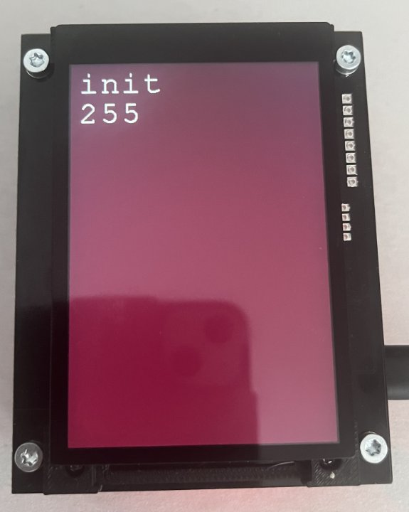

I got the touchscreen working. It's very easy to use. It's simple to start and stop a recording using the large touch fields.
unfortunately...
I'm still having problems with the SD card—it won't initialize.

There is a problem if I try and initialise the card multiple times, it works the first time but then returns 255 every time after that. If I uninitialise the card as part of the loop then I can init over and over again and always get a return value of 0.

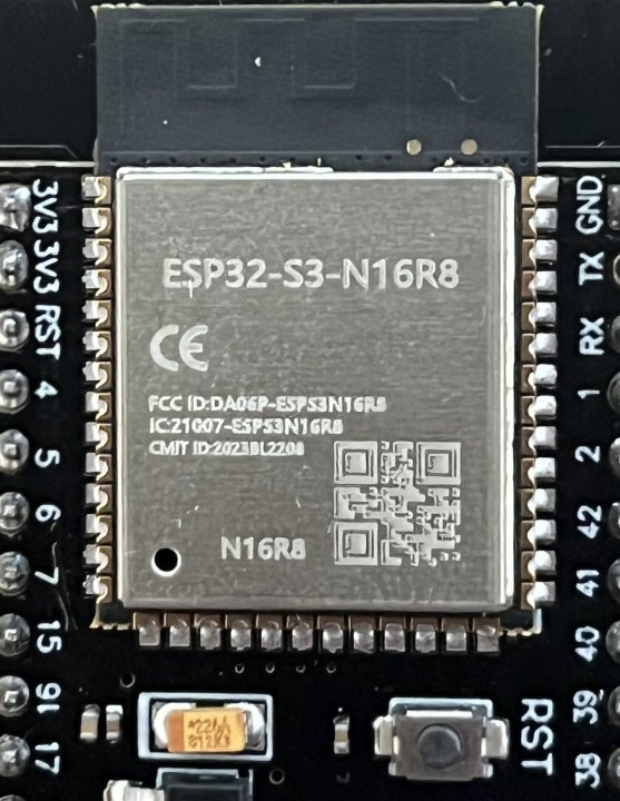

One problem that was reported via eBay was the S3 module itself. On my test board I have the ESP32-S3-N16R8. Which version of the S3 module do you have there? I know there are some minor differences to do with the PSRAM.
Interestingly I'm using a version with the larger PSRAM which technically shouldn't be possible as it's using the pins assigned to the SD card. I wonder if the PSRAM has to be activated somewhere in the menu config and you are making use of it?

1) What version of the ESP32 S3 WROOM module is on your board?
2) Have you been into the menuconfig and changed any settings to do with RAM or PSRAM?

on my board is: No I did not use or change RAM / PSRAM
And yes ! It's working now.
I changed my touchprogram and add the sd-card with a single init the card.
I creat a file Test.txt and save the string "Hallo" to the file And... You're right if the card send once 0 for ok you can not init again. You need to uninit first.
I tested with the stop button to uninit b4 I init again.I will include this into every sd-init loop.

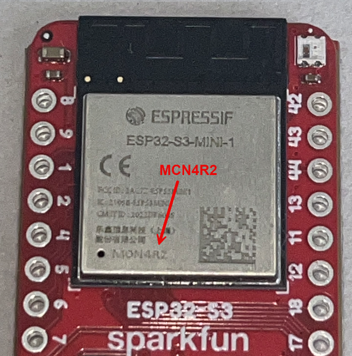

The card doesn't work yet on the other two boards. Both have the S3-mini1.
The SparkFun board already has the card built in. Are there any differences between the ESP32-S3_DevKitC and ESP32-S3_MINI regarding the SD card?

The N4R2 only mentions IO26 being not available. I can't see there's any differences with the SD software library.

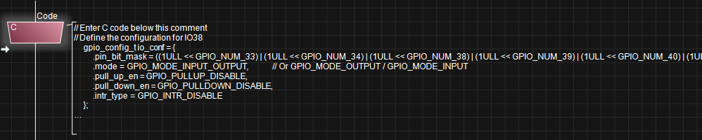

IO38, 39, 40, 47 has PHY USB associations on that device, you maybe have to disable the PHY USB functionality?
You could try forcing each pin to be in standard IO mode using code like this for each pin.
If that doesn't work then talking with Gemini it recommends using this to burn out the efuse just be careful it doesn't disable you from reflashing the board.
// Define the configuration for IO38
gpio_config_t io_conf = {
.pin_bit_mask = ((1ULL << GPIO_NUM_33) | (1ULL << GPIO_NUM_34) | (1ULL << GPIO_NUM_38) | (1ULL << GPIO_NUM_39) | (1ULL << GPIO_NUM_40) | (1ULL << GPIO_NUM_47)),
.mode = GPIO_MODE_INPUT_OUTPUT, // Or GPIO_MODE_OUTPUT / GPIO_MODE_INPUT
.pull_up_en = GPIO_PULLUP_DISABLE,
.pull_down_en = GPIO_PULLDOWN_DISABLE,
.intr_type = GPIO_INTR_DISABLE
// Apply configuration; this overrides the default USB-OTG routing
gpio_config(&io_conf);Code: Select all
espefuse.py -p PORT burn_efuse DIS_USB_OTG_DOWNLOAD_MODE 1Regards Ben Rowland - MatrixTSL

I just pasted the C code as-is, but I think that was a mistake on my part. No error, but no improvement either. I tried the component for the SC/SDHC with SPI, and it works nice to creat a file and save a string.
