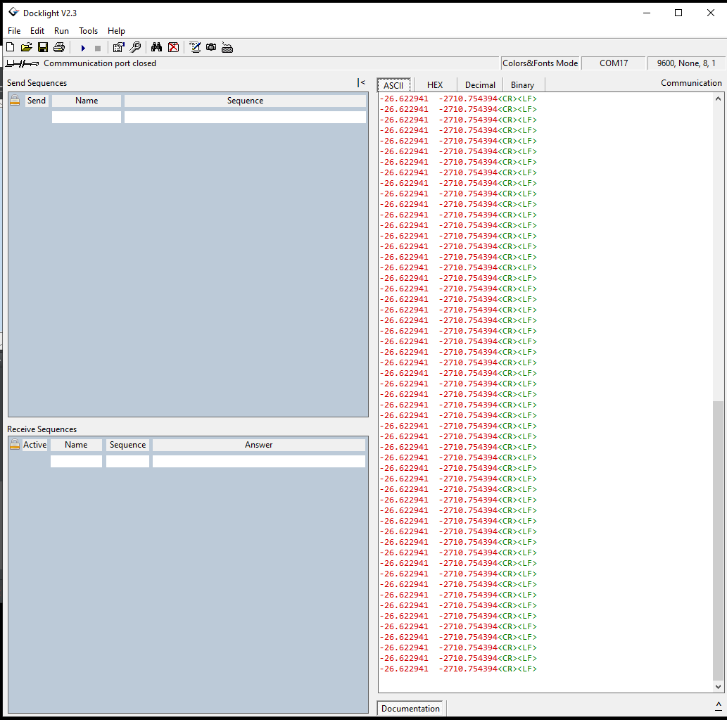

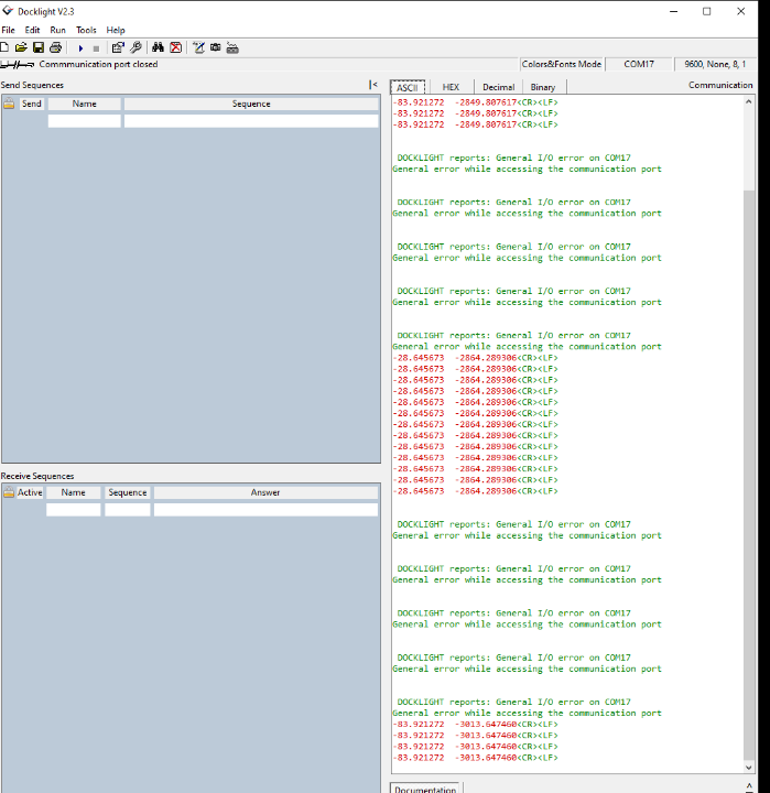

Hello and good morning,
see pictures
Once started, the value is always the same, even if I increase the temperature or pressure.
In the second picture green writing I switch off the PIC and restart it.
there are again random values that remain constant.
The average air pressure at sea level is 1013.25 hPa. a somewhat lower pressure should be displayed, as I do not live by the sea.
Why are there minus values?

Re: Adafruit DP310 Precision Barometer
It looks like it's never updating the variables and what you're seeing is just an uninitialised variable. Hence the fixed random value.
It was all working fine for me here with temp and pressure giving good readings but that was via the API slave interface so I was talking to the sensor via the Flowcode simulation via an Arduino Uno. I'll do a compilation test and see if I can replicate the problem you're having.

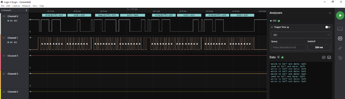

hello
here is a recording of the data transmission to the sensor
greetings
Thanks for letting me know. I have replicated the issue. It works fine in API mode but not on the device itself so it's either some timing issue or a problem in the maths. I'm on with debugging it but so far no joy.
