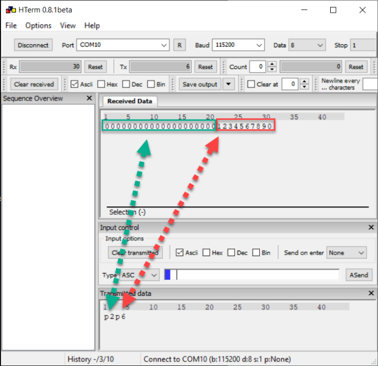

If I send "p1" the Modul send me back 20Char of "0". this is working very fine and many times without a problem.
But when I send "p6" the Modul should give me 20 char back, but it's crash and hang.

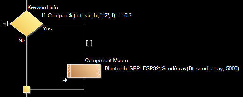

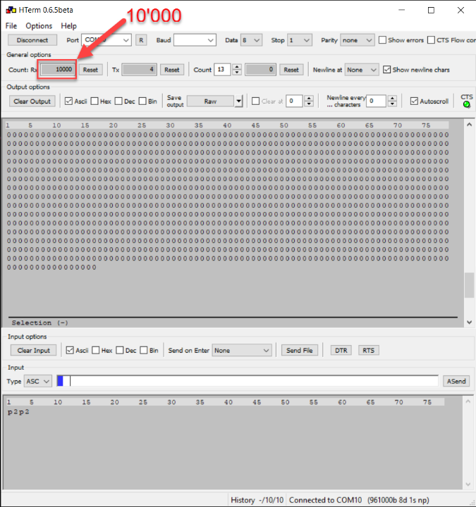

I made a test with the byte array.
I have increased the array to 5000 bytes !! and I can send this twice (or more times) without any problems
